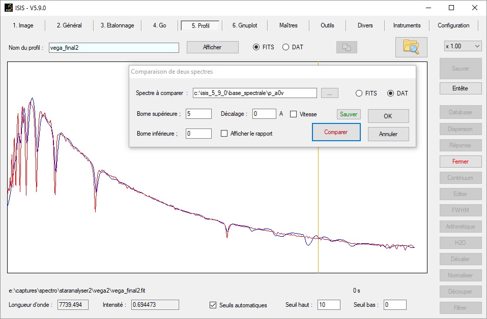

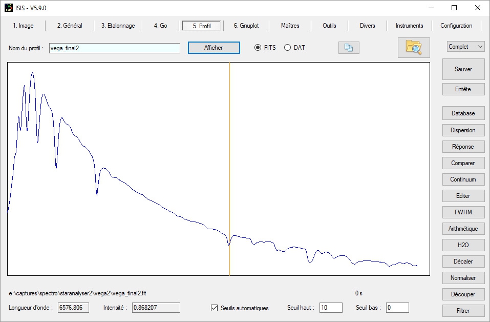

sur Véga, (StarAnalyser+Atik383+T200/1000) j'ai obtenu ce profil:
lorsque je compare avec le spectre A0V de la base spectrale:
ma question: à part la copie d'écran, y-a-t-il la possibilité de sauvegarder le comparatif?
merci

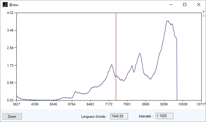

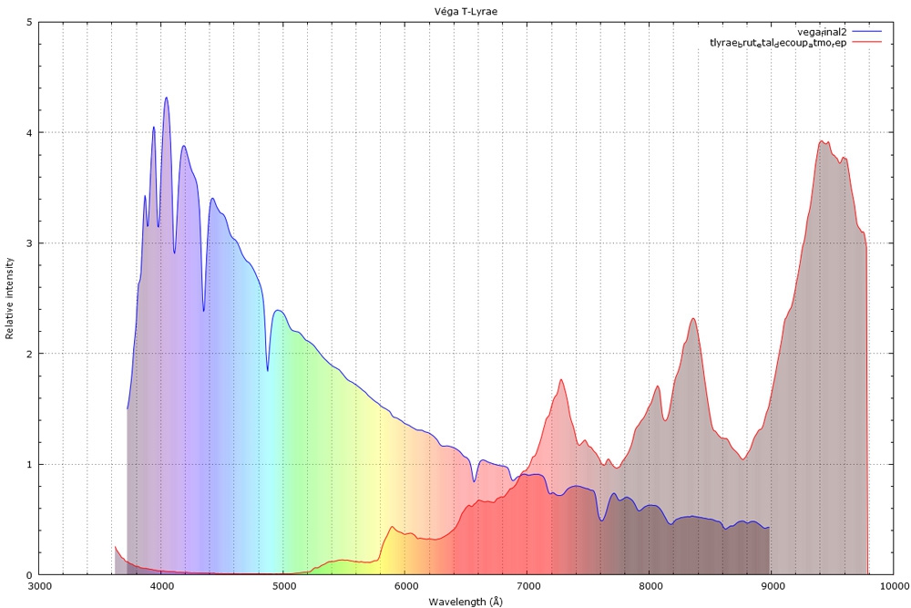

question subsidiaire (mais qui n'a rien à voir :D )
ce spectre de T-Lyrae vous paraît-il cohérent?
Star Analyser 100; Atik 383L; T200/1000

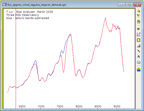

Your Star Analyser spectra look good :-) but I think the wavelength calibration for T Lyr is not quite right.
Your wavelength values look ~ 7% too high when I compare with my 2008 Star Analyser spectrum,
from this page
http://www.threehillsobservatory.co.uk/ ... poster.pdf
and with Christian Buil's spectrum
http://www.astrosurf.com/buil/us/spectro9/tlyr.gif
from this page
http://www.astrosurf.com/buil/us/peculiar2/carbon.htm

Hello Gerard,
Your Vega wavelength calibration is good so you can use the same calibration for T Lyr. Use the position of zero order (= 0 Angstrom) and the same dispersion (A/pixel) that you found for Vega.
