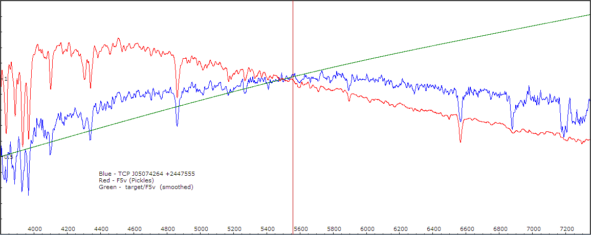

The spectrum seems to be that of a white-yellow star reddened by interstellar dust. I tried to remove the extinction using the value E(B-V)=0.4 (not far from than as indicated by IRSA Dust service for the target coordinates). Just a test...
By comparing the dereddened profile with Pickles library profiles, I feel like I see a similarity with the intermediate F spectral class. In the following graph, the target spectrum is compared with Pickles F5V and F5III.
I don't know how long is an event like this. The raising steep phase began about 10 days ago (from the ASAS-SN light curve). Maybe there will be no spectra changes with time but I think it's interesting to know that there are such objects.

Hi Robin, Paul, thanks for your comments. I read the Robin message on Spectro-l with updates, very interesting. The lack of X-ray emission and the normal brightening in the UV (same amount of optical) confirm there is not an intrinsec variability but we are observing a microlensing event. The ASAS-SN light curve indicates that the fading phase is already started.

Firstly, the extinction is related to all Galaxy dust for a line of sight. Indeed, E(B-V) is calculated using the colour of a number of elliptical galaxies. So I think we could consider it as a maximum value (the target might be found closer to us). Furthermore the resolution of extinction map does not take into account the fine structures in the interstellar medium.
For our target I initially used the returned E(B-V) value for the coordinates (0.5), then I start comparing the dereddened profile with the Pickles series exhibiting similar absorption lines. Found the spectral class that better matched the lines, I adjusted the value so that the continuum slope matched with the selected Pickles profile (~ 0.4).
