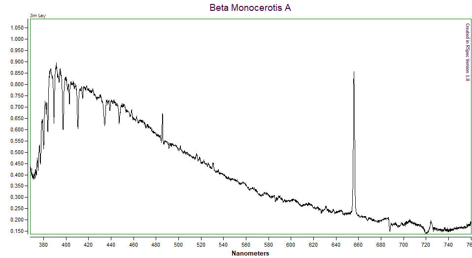

Here are some spectra I took of the three components of the Beta-Monocerotis system. They are all Be stars with emission! A is separated from BC by 7.4” and B and C are separated by 2.8”.
Here is the spectrum for A

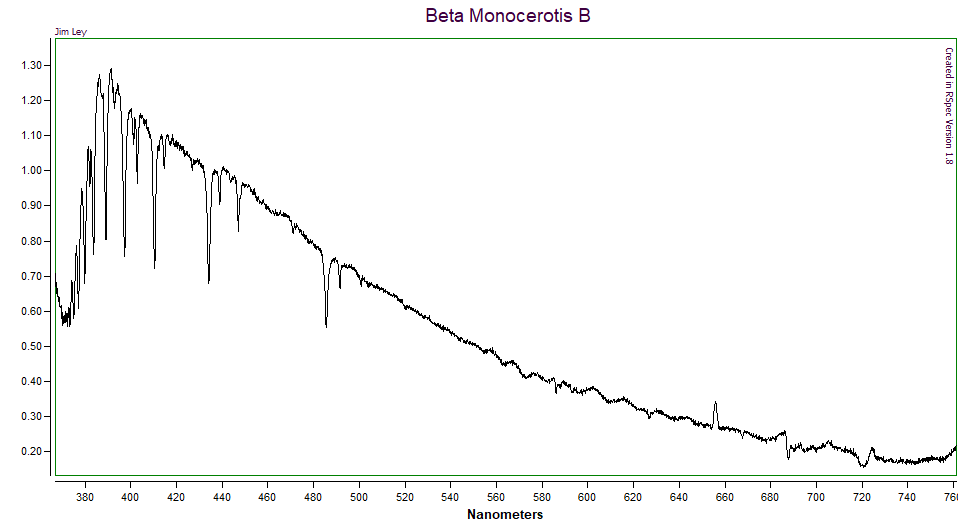

Here is the spectrum of B.
Beta Mon B.png (13.75 KiB) Viewed 8457 times

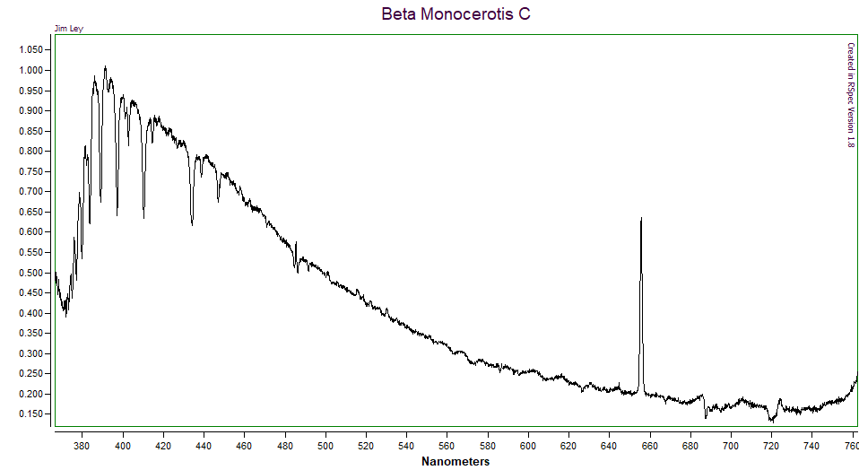

Here is the spectrum of C.
Beta Mon C.png (15.81 KiB) Viewed 8457 times

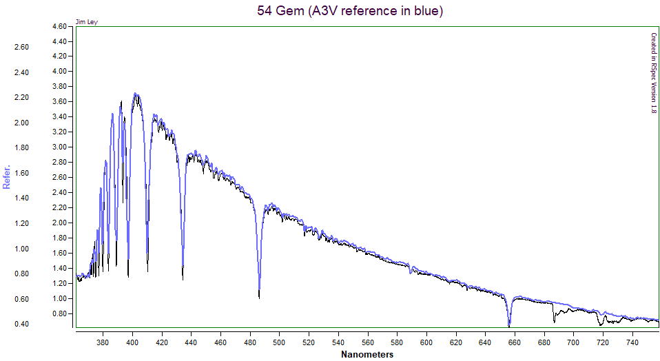

I used 54 Gem as my reference star 8 x 60s
54 Gem a3V reference.png (18.81 KiB) Viewed 8421 times
Notice that the noise you saw from 540 nm to 600 nm is now gone. This was removed by my flats correction.

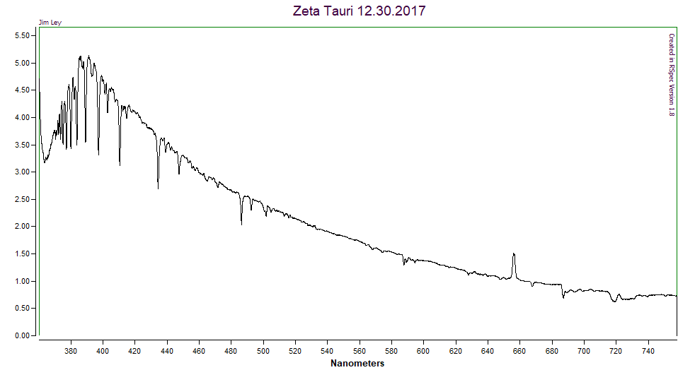

I used this reference to calibrate my spectrum of Zeta Tauri 19 x 25 s
Zeta Tauri 12 30 2017.png (12.4 KiB) Viewed 8421 times

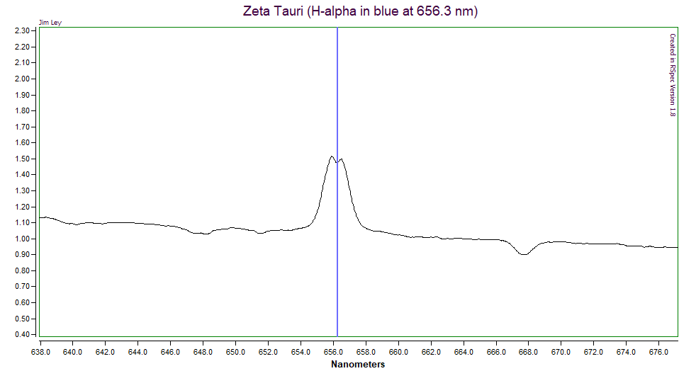

I thought it was interesting that I might see a double peak for H-alpha. Robin Leadbeater made the helpful suggestion that I pursue a smaller slit for the ALPY600 to improve the resolution.
Zeta Tauri halpha.png (12.78 KiB) Viewed 8421 times
I would also be very happy to share this data with you if you tell me how.

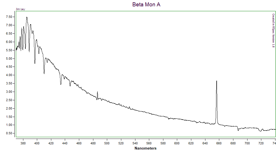

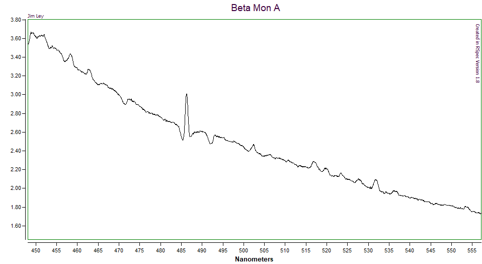

I was able to process the spectrum of Beta Mon A with ISIS. Therefore this image is calibrated and corrected using 14 Lep as a nearby reference star. I think it is interesting to compare the single capture above with this average spectrum
Duration : 726.0 secondes
Resolution power : 516.3
Beta Mon A full.png (12.58 KiB) Viewed 8354 times
I looked at some echelle spectra of Beta Mon A and I could see many of the metal emission peaks that I see here. At high resolution, many were split into two peaks with the central absorption extending below the continuum. In my low resolution spectrum these peaks seemed broad or flat topped, with a few having a small dip in the middle. Again, I think a 9 um slit might be interesting. Here's a zoom of some of those emissions.

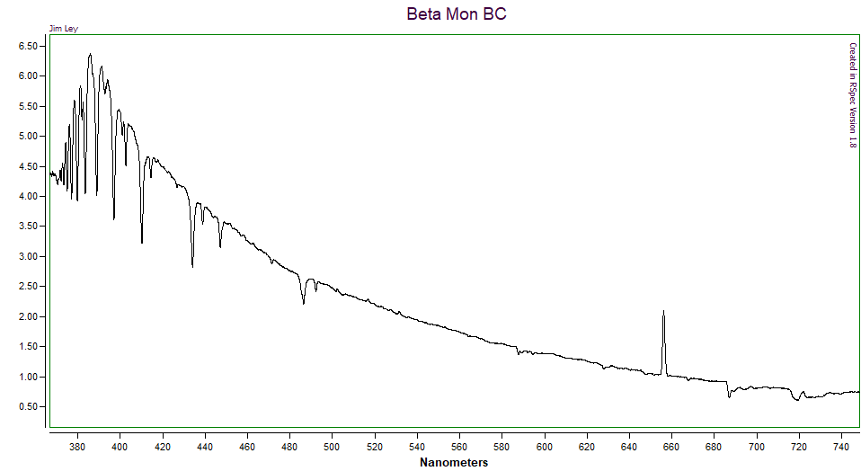

Here is the spectrum containing both Beta Mon B and C.
As I thought, I was unable to separate the two components, although they were visible in the image. The H-beta emission of Beta Mon C is gone, but the absorption has a weird bump. Next chance I get I'll rotate the slit to see if I can't get good spectra of B and C separately.
Duration : 1448.0 secondes
Resolution power : 553.0
Beta Mon BC.png (12.29 KiB) Viewed 8353 times
One of the (many) aspects of ISIS that I don't understand is the Binning Zone Adjustment. If I make it too narrow (even though the spectrum doesn't seem outside the range), my spectrum is sometimes unusable.
