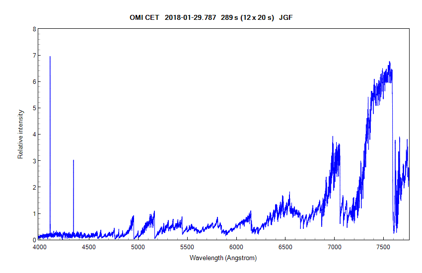

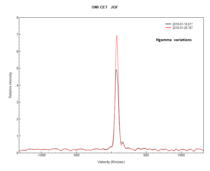

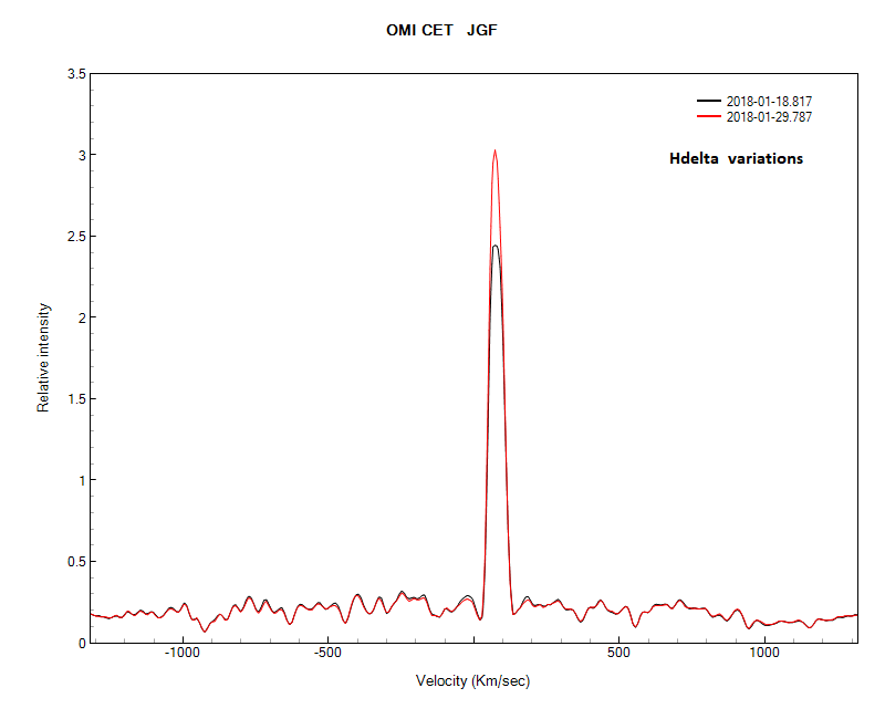

The graphics showing intensity variations in the Hgamma and Hbeta, on the Omi Cet star. Is that normal ?
J. Guarro.
HYDROGEN VARIATIONS IN OMI CET

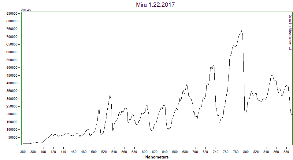

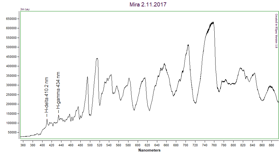

Here are two spectra that I took of Mira last year with the Star Analyzer 100.

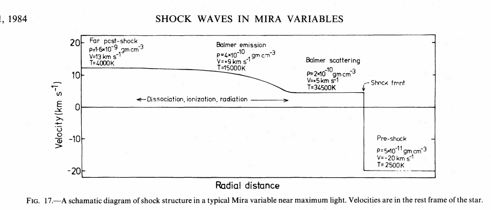

The emission lines in mira stars is the result of the pulsation of the external layer. Typical velocities of the expending and recessing layers are ~ 10 - 20 km/s.
Balmer lines appears near maximum luminosity as result of the propagation of a shock wave which produces locally a strong enhancement of the temperature (from about 2500 K to several 10000 K). This produces dissociation of H2 molecule, ionisation and or excitation of H atoms. In the relaxation zone, H recombines and cascades, producing the emission lines.
The physical conditions (strongly non LTE), optical depth, ... explain the anomalous Balmer decrement which is far from Case A or B
Note that the anomalous
line ratios (e.g., Hy/H<5 ~0.7) may also be explained by
having a moderate optical depth to Balmer line radiation in
the immediate postshock region. The scattering cross section is
lower for higher order members of the Balmer series so that
they will suffer less attenuation than lower order members.
This will cause a reduction in line ratios such as Hy/H<5.
Finally, we note that the weakening of the negative velocity
emission component past maximum is due to the decrease in
the scattering optical depth through the hot immediate postshock
region. Fox & al. 1984
Shock waves in Mira variables (Fox & al.,1984,1985)
http://adsabs.harvard.edu/abs/1984ApJ...286..337F
http://adsabs.harvard.edu/abs/1985ApJ...297..455F
see also a summary in Astrophysics of Emission-Line Stars (2007) p.346
