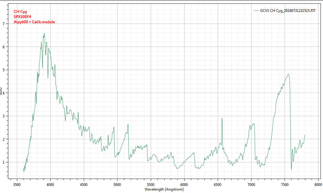

- CH Cyg M7IIIab+Be star (?) AAVSO Alert Notice 639

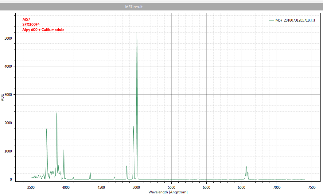

- M57

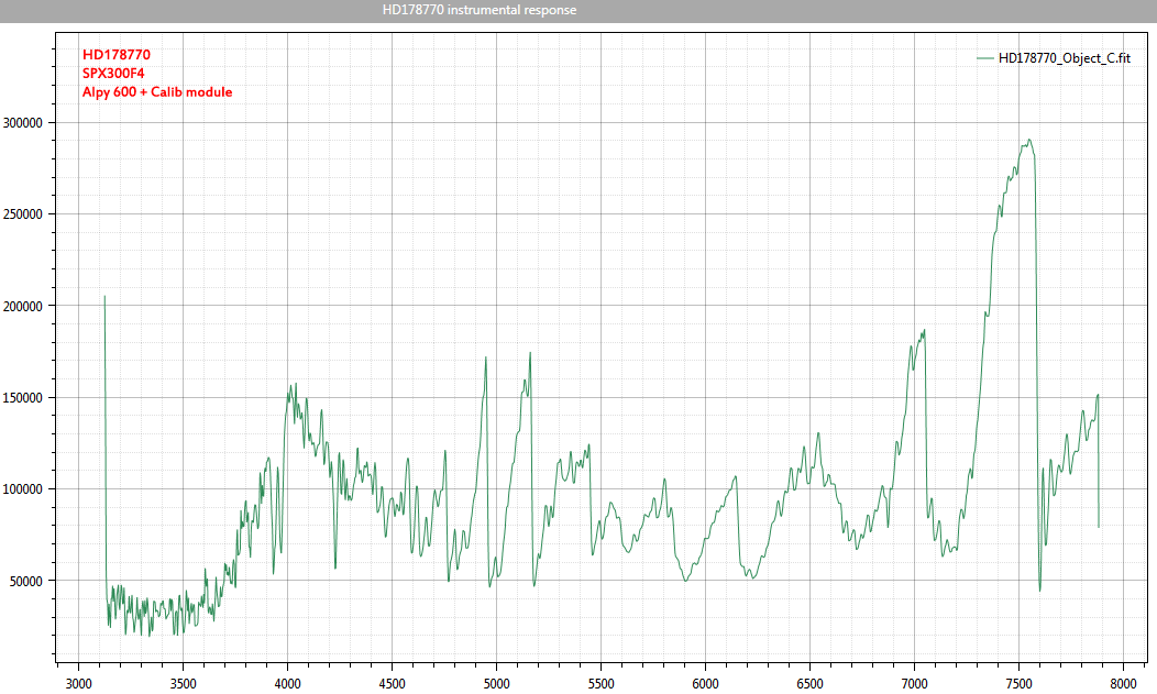

- HD178770 In Lyra, M6 star (I took a look and it look interesting, almost like CH Cyg)

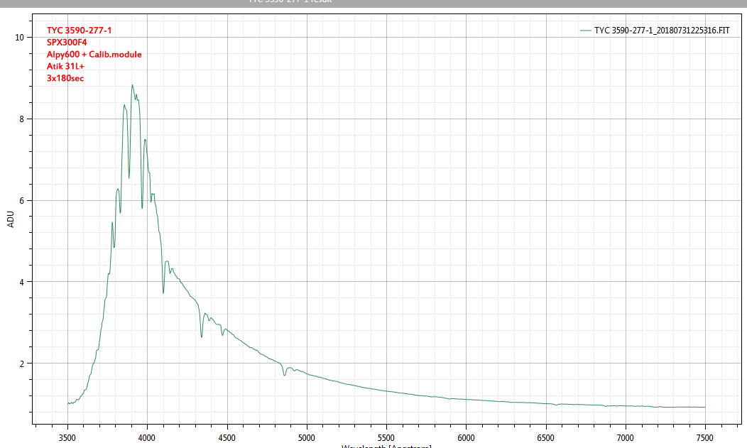

- TYC 3590-277-1, B5 D ~ star (spectroscopic doublestar)

I have tested my Alpy one short "night" 31.7.2018, and took some pics 12"F4 Newton without coma corrector (should it be used, I assume that less glass between object and CCD is better ???)
I did some training 1D spectras with Demetra. These do not have instrumental & atmospheric corrections because then things will become complicated (to me).. it looks like instrumental & atmospheric corrections is worth learning - well.

- CH Cyg.png (81.33 KiB) Viewed 6908 times
- M57.png (58.44 KiB) Viewed 6908 times
- HD178770.png (85.7 KiB) Viewed 6908 times

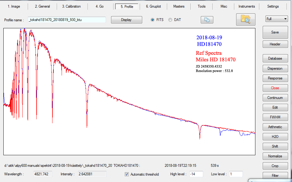

Last couple of weeks i beaten head against the wall with ISIS - made stupid mistakes and received poor results. Finally a few of days ago I think I got it. I still do not trust 100% the results. Robin's proposal is therefore more than welcome!
Some results so far:

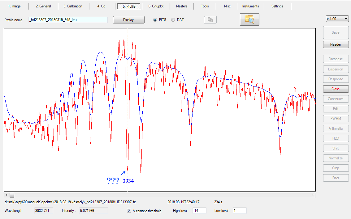

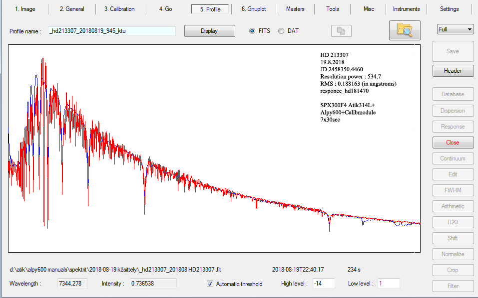

HD181470 , my ref star.
HD213303, corected with HD181470 response profil . Actualy I thought using HD213303 for Mu Cephei, but Miles spectra for HD213303 look quite complex - is this Be star ? And my Alpy miss absorbtion line in 3934 Å.

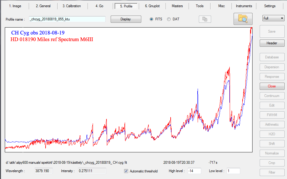

Ch Cyg 2018-08-19 looks otherwise good but do blue end go right (?) Corected with HD181470 response profil .

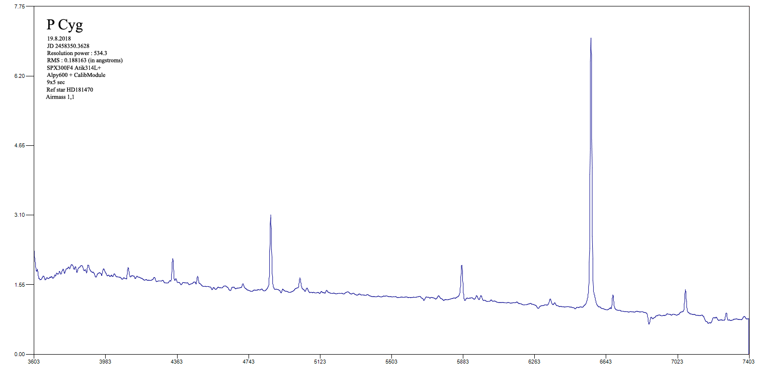

P Cyg ...I'm not sure about this. Corected with same HD181470 response profil.
I have to do Robin's test!
Cheers!
Timo K.

Re: Choosing right reference star?
The spectrum in MILES for this star (HD213307, not HD213303) certainly looks strange. The 3934A line is Ca K and should not be there in an A0 star. I wonder if the MILES spectrum is contaminated by nearby Del Cep ? The same star is in ELODIE 3.1 where the spectrum looks more sensible. I any case it looks like the MILES spectrum of this star should be avoided as a reference. (This is the second suspect spectrum to be found in MILES in the past few days which is worrying (The other is HD216916, reported on spectro-l)Timo Kantola wrote: HD213303, corected with HD181470 response profil . Actualy I thought using HD213303 for Mu Cephei, but Miles spectra for HD213303 look quite complex - is this Be star ? And my Alpy miss absorbtion line in 3934 Å.
