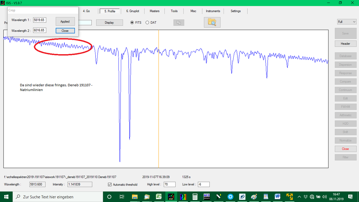

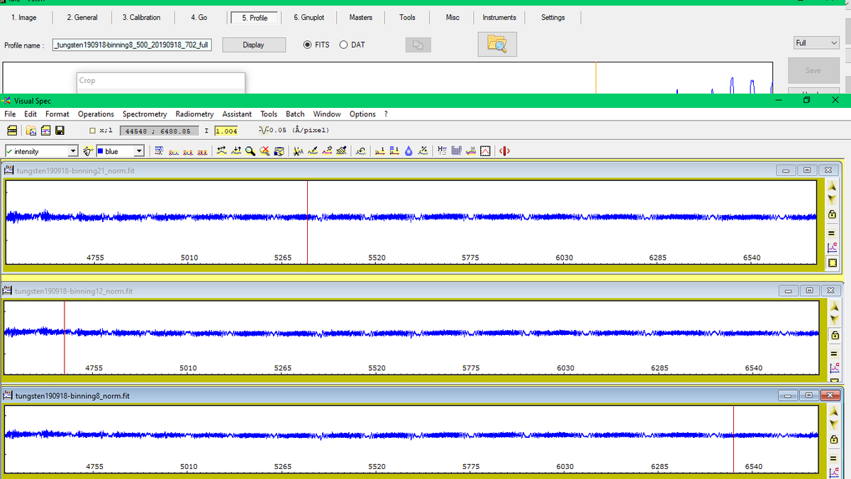

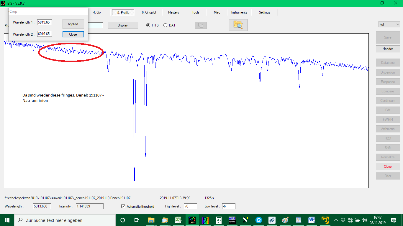

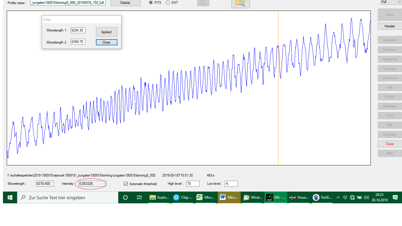

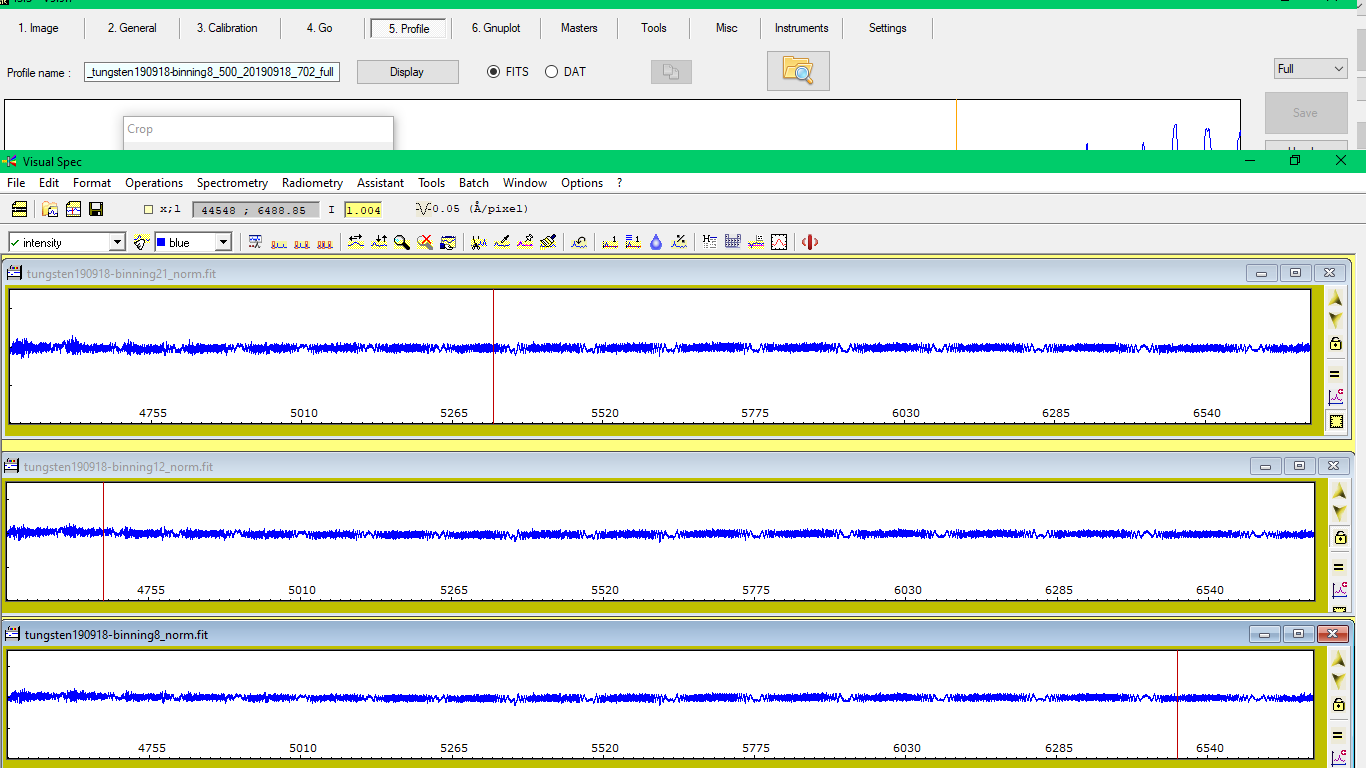

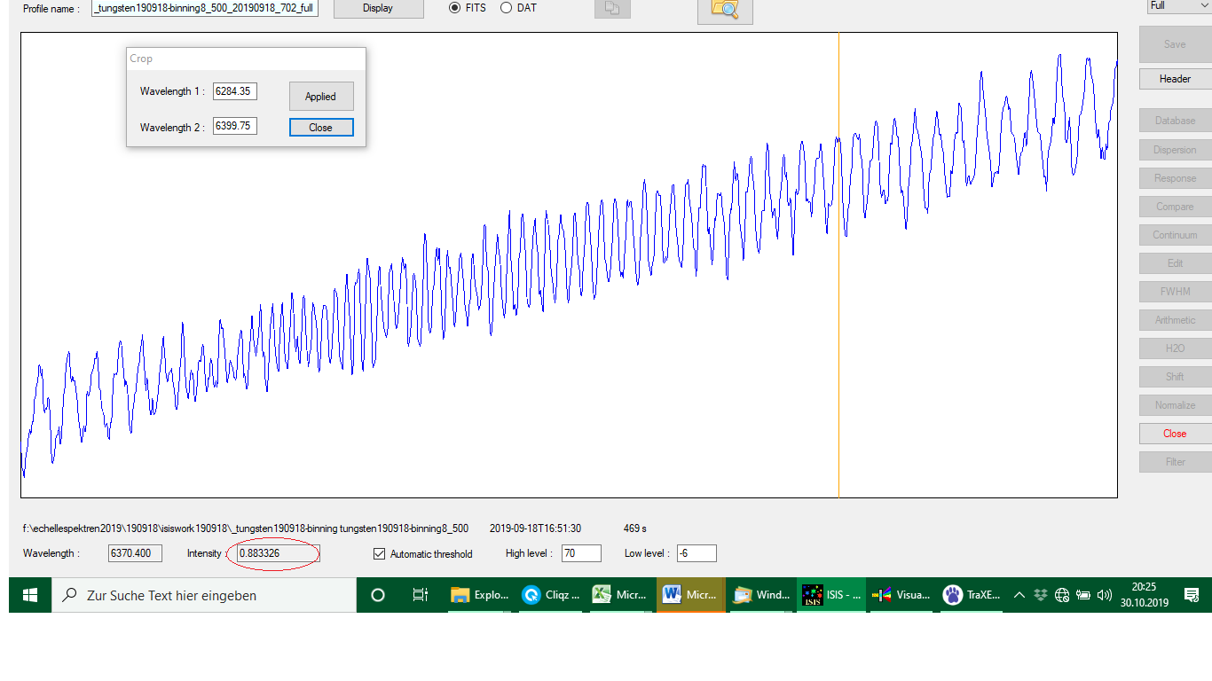

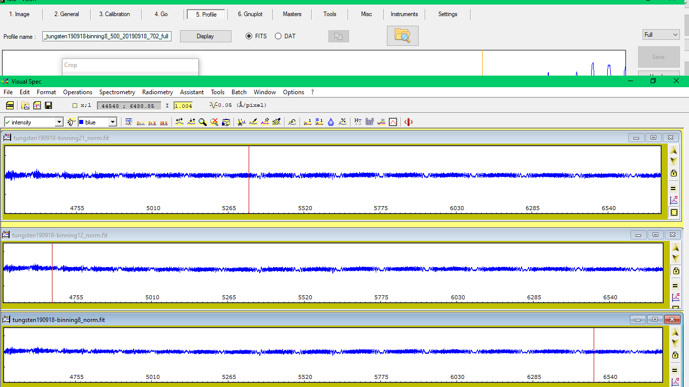

I found, that ISIS seems to create strange effects, visible by extracting a 2D flat_tungsten. Look the adnex please. If I extract the same flat with midas those "fringes" are not visible!
Could anyone tll me something about this phenomena?
cheers Berthold

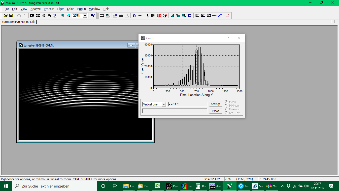

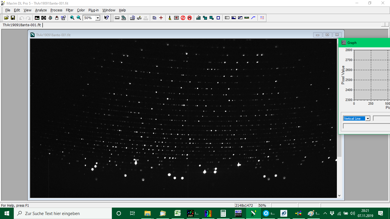

I suggest that you publish the aspect of the (2D) image of a typical tungsten spectrum and of a spectrum of the thorium-argon lamp.
I suspect that you work in 2x2 binning with your camera. That's right ? I's an Atik460EX model?
A screenshot of the "eShel tab" and the "eShel-> Setting tab" has also well come.
(Note also that using the calibration tungsten lamp is not the best way to evaluate the response of your spectrograph: result is depending, for example, on how the science fiber is illuminated by the light coming from the calibration fiber in the guidance module - did you realize this centering by observing with the guidance camera?).
- Posts: 35
- Joined: Thu Apr 21, 2016 8:15 pm
Re: Bad efficiency of the eShel from shelyak
Thank you Christian for answering!
Yes I'll publish the tungsten und ThAr 2D !
No, I'm not using 2x2. binning , I use a KAF 3200 1x1 binning!
Yes I'll publish the setting file!
Ok, it could be that the light from the 200 mue fiber is not perfect centered over the pinhole, But!!!
I know a professional Astromer who reduced the SAME files with Midas and there is nothing to see from those "fringes" . Therefore It is nearly not possible that those phenomena are caused by my equipment.
This astronomer told me, that the "slit with" of the software is to small. One can change this slit with in Midas but not as fare I can see it is possible to change it in ISIS (?)
( I get no information via email if an answer is incoming here even if I have it switched on)
Cordialement et merci beaucoup
Berthold

ok there are the files to see. I'll send you via wetransfer the files as 2D . They are to big, so I cannot upload them here.
Is it what you need?
If you need more informations please let ist know me.
Cordialement Berthold
(In the calibration unit I have a tungsten lamp with only 5 W. Therefore we have no much light in the higher orders. I have a special computed filter which allows me to have less enrgie in the red part and more in the blue part of orders. but this lamp is to week for this filter. Do you know if the calibration unit can tolerate higher power lamps?How many Watts are posible?)

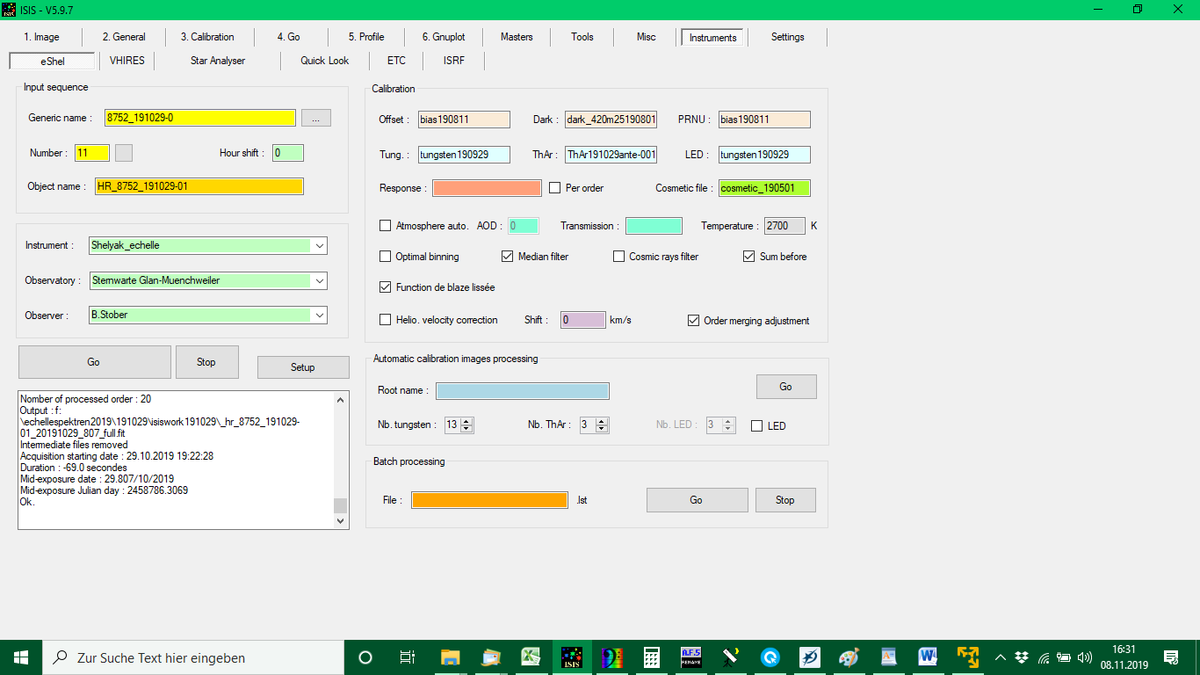

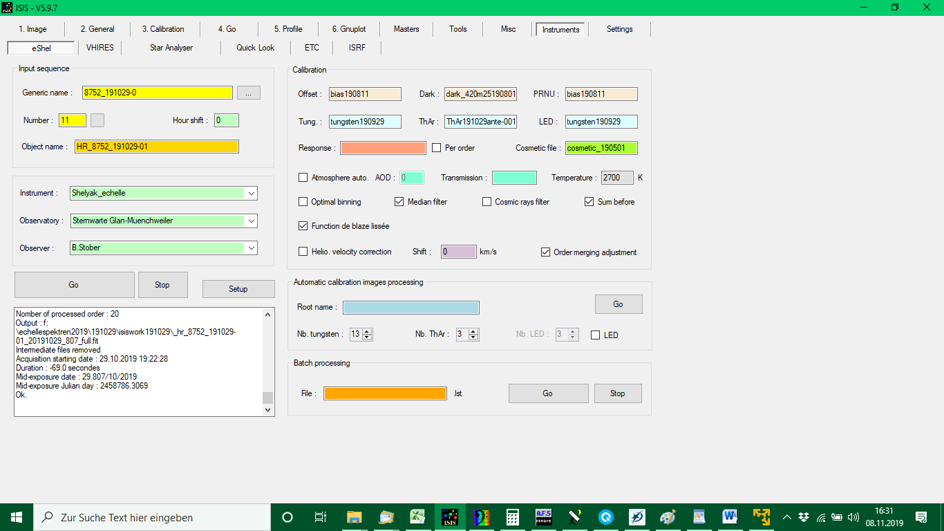

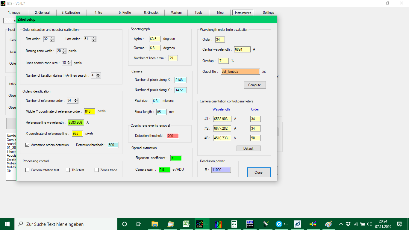

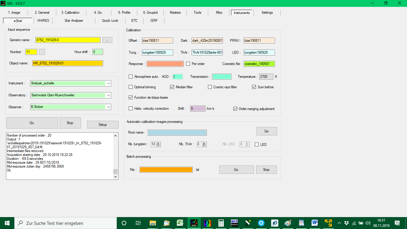

Thanks for the infos. For complete, capture and publish a screenshot of the main "Instrument - eShel" tab.
- Posts: 35
voila l'image d'ecran. Est ce que ca suffit pour le moment? J'ai envoye les 2D frames via wetransfer.
Berthold

I would like to publish there the ".....full.fit" 1D but this seems to be impossible.
berthold
