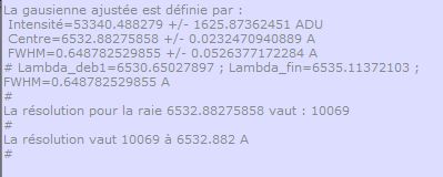

Now i reprocessed the same spectrum with the latest SPcAudace software and the new files downloaded an placed in the SPcAudace folder:
I get a R= 10069 . This is a big difference with the processing in june 2019 of the same spectrum. (see audela's console screenshot below)
Maybe i do something wrong, but i follow the same steps as always and now i see for the same spectrum 2 different values: in june R=14062 and now R=10069.

Hi Erik,
There has been an inversion between low resolution andd hight resolution case in spc_resolution computation.
Now the issue is fixed. I found R=13569 for HD201733 and R=12688 for HD22780.
You can download the patch (spc_calibrage.tcl).
Benji
