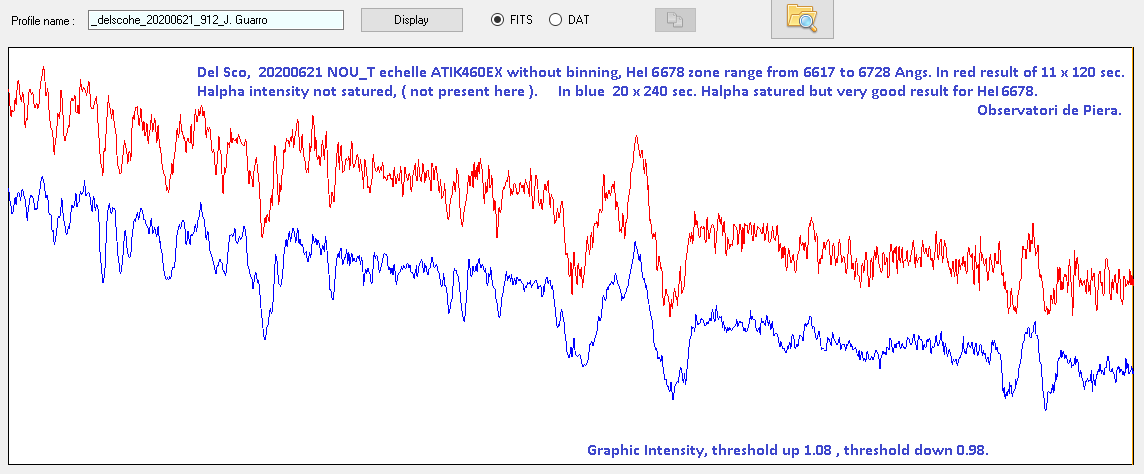

Well, I show for all a graphic of HeI 6678 three days ago.
Friendly, Joan.

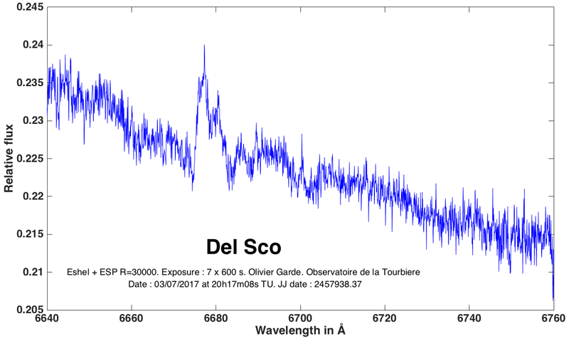

It's possible with the eshel spectrograph to shift the spectrum in X axis and catch the He I 6678 lines well placed in the order #33, but in this case I can't have H beta in a single order (with an ATIK 460ex H Beta and others Balmer's lines are split in two parts on 2 orders, so not very useful to merge correctly the 2 orders)
So it's a choice, I prefer to have all my Balmer's lines well placed in a single order than have He I 6678 line and If I want to study only HeI 6678, I prefer to use a mono order spectrograph like LHIRES III.
Except with my whoppshel spectrograph where I can have He I 6678 well placed with R=30000.

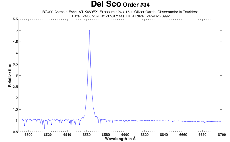

I made some modifications on my eShel to have HeI 6678 better centered on the #34 order and also H alpha line.
Here's the result with the full #34 order with H Alpha and He1 6678
And a crop on the HeI6678 line only
The main problem comes that the H alpha line of Del Sco is very intense compared to the HeI which does not allow to have simultaneously the 2 lines with a good SNR.
HeI emission is very weak on Del Sco....

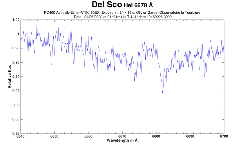

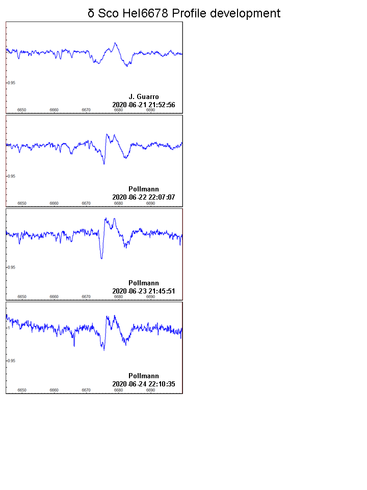

as you know, I used already your excellent HeI6678 spectrum taken with your NOU_T-Echelle (attachment). There are obviously ways with this sort of spectrographs to receive useful spectra with a very well S/N. As your result shows, simply to increase the exposure time did lead to success. An earlier statement in this forum, there is no way to reach that, seems to be disprove.
Hi Olivier,
indeed, to receive an useful HeI6678 spectrum of delta Sco (and for gamma Cas too; see: https://www.aavso.org/gam-cas-campaign-01) with an acceptable S/N is a challange, I know. In this sense your spectrum from 2020-06-24 is really not useful (compare it with the attached spectra sequence) . Also here I would like to recommend, clearly to increase the exposure time, similar to Joan.
Concerning the sense of studying the HeI6678 profile variability you should read the link at this forum:
http://www.spectro-aras.com/forum/viewt ... =14&t=2506 Ernst
Hi Olivier,

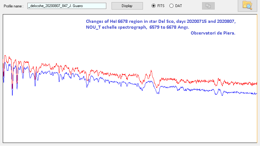

The observations of HeI6678 in Del Sco are being continuing.
Who of you want to join to us observe this star ?
J.Guarro.
J.Guarro.
- _DELSCO 20200807.png (16.8 KiB) Viewed 4372 times
