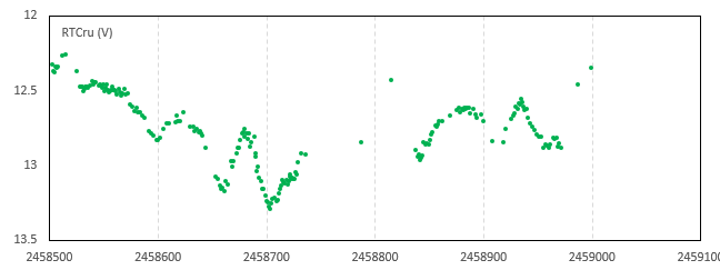

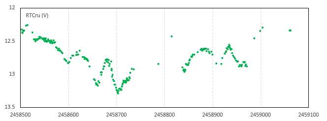

AAVSO lightcurve:

It remains at high luminosity (~ 12.3) according to recent observations in AAVSO data:
Comments from Juan:
During the last month or so, the Swift BAT flux has been steadily increasing and is coming out of the minimum that started about 1-2 years ago. Spectra now and for the next 6 months will be really useful as this is an opportunity that might happen again in ~10 years (if this is indeed periodic as we suspect).

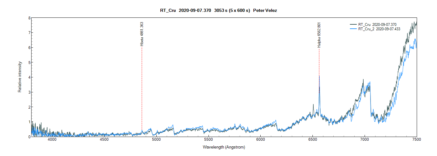

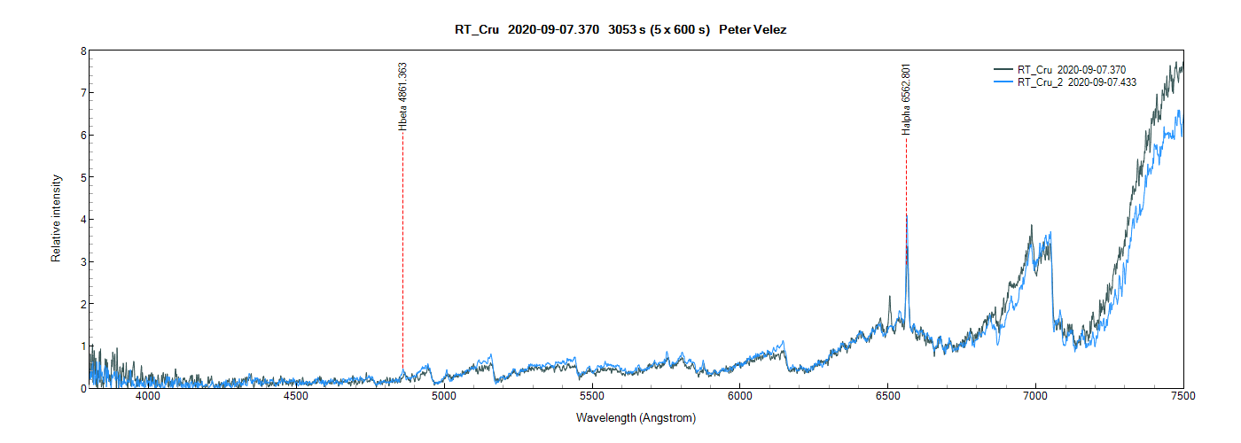

This was a challenging task - I started imaging last night when the target was at around 33 degrees altitude and it dropped away from there. I was surprised that it didn't slip below the walls of the observatory. I shot 2 separate sets of images and have processed them separately.
Here are the results. Very ordinary spectral calibration and low SNR. But it does show Ha emission and a few other interesting emissions.
I will give it another go tonight - weather permitting.
Pete

That's excellent, Peter
I think you have also He I 5876 and probably [OIII]
Comments from Juan Luna:
Thanks a lot for taking this!, it is exactly what I was expecting!, Halpha emerged. Ideally we would love a weekly cadence, but I know it is difficult, so anything between once a week and once a month would be greatly appreciated.
