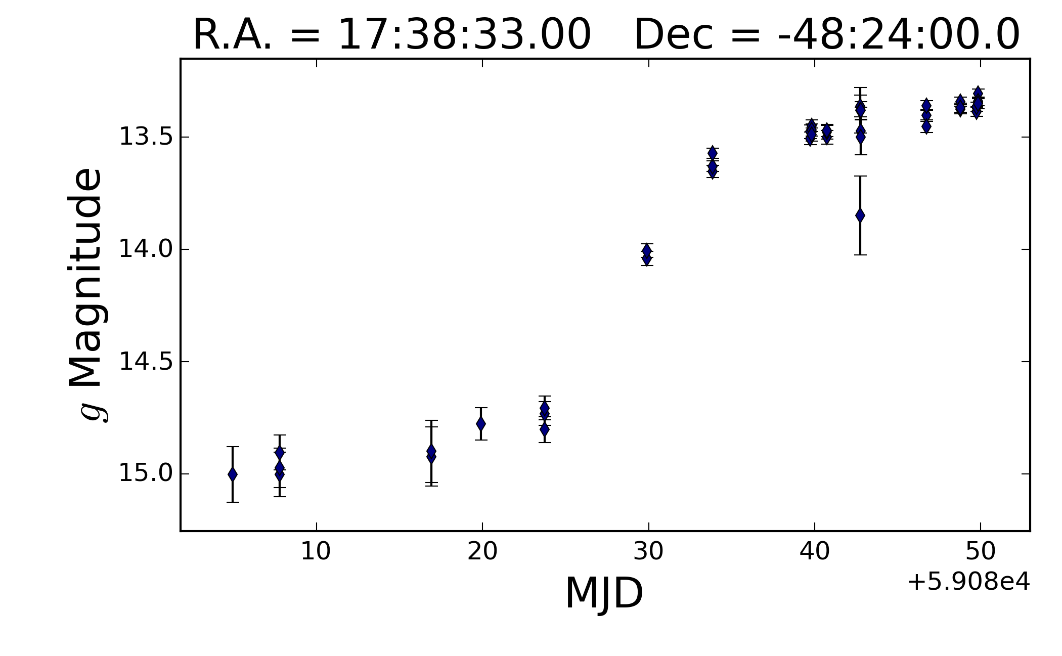

I think the point of interest is that it was thought to be a microlensing event, but the curve now doesn't look much like that, so nobody is quite sure what it is...

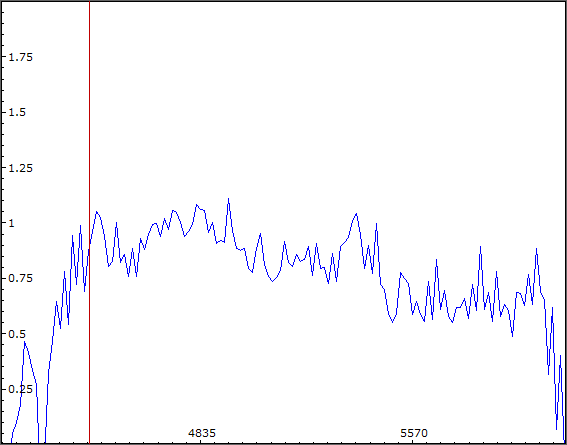

Here is my results from three nights (5th, 13th and 15th october). Total of 200minutes exposure with SA100 on 200mm f6 newtonian. S/N is pretty poor but better than nothing I guess. Should i upload to BESS?

It looks roughly like an F/G star from the continuum shape so not your typical CV or variable red giant. It could be a lensing event (The test for lensing is no change in the spectrum with brightness)
BeSS is only for Be stars. You could add it to the BAA database which accepts spectra of any astronomical object. Star Analyser spectra are accepted if they are of a unique event.
EDIT just seen the light curve. I agree, not a typical microlensing curve

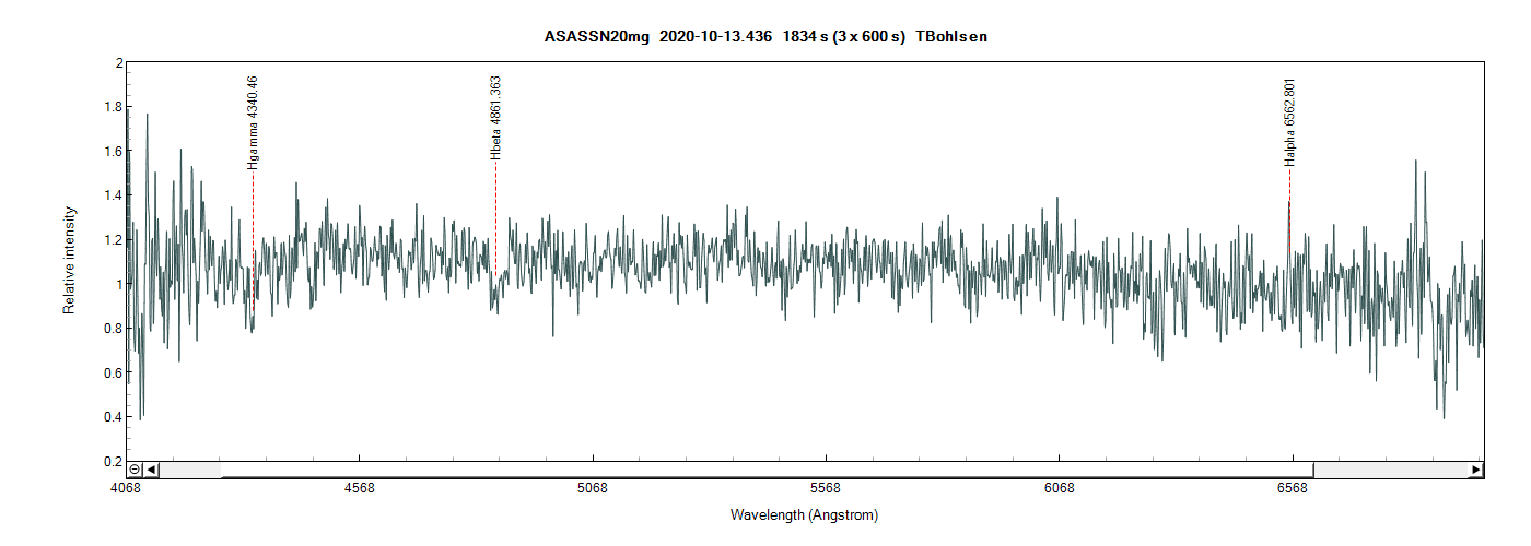

sorry I'm slow getting this too you.
My spectra was taken with my LISA.
It is pretty noisy as it was low in the west when I took it.
The continuum is pretty flat. There is certainly Hb and Hg absorption and weak Ha absorption maybe buried in the noise.
Certainly there are no major emission lines anywhere.
