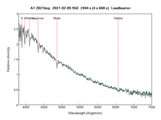

Re: FW: [vsnet-alert 25335] TCP J10203579+3103424 = AT 2021b
High amplitude dwarf nova outburst
http://www.astronomerstelegram.org/?read=14374
A spectrum from last night (ALPY600). 1D fits file in BAA spectroscopy database
