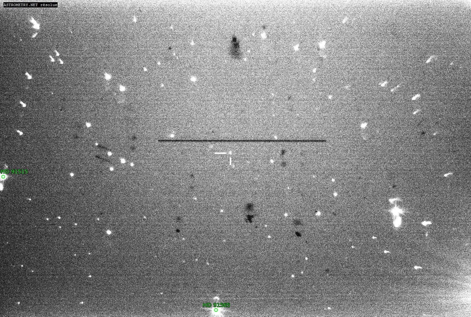

Here is a view of my guiding camera, through Astrometry.net :
Astrometry
Astrometry

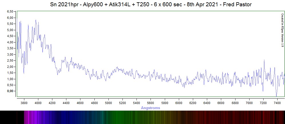

After 6 pictures of 600 sec each, and star reference with HD107193, I obtained the following Spectra :
Sn 2021hpr
Sn 2021hpr
Sn2021hpr 8 avril 2021 Fred Pastor.jpg (73.27 KiB) Viewed 7794 times

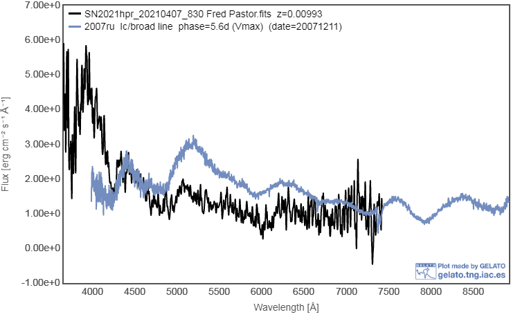

Despite noise (the seeing was excellent and clear sky but I think I reached the limit of my set up), we could recognize a type I b/c with broad lines. It also matched in Gelato database with the SN 2007ru,in term of continuum at least.
gelato SN2007ru
gelato SN2007ru
gelatoplot (5).png (55.98 KiB) Viewed 7794 times

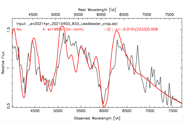

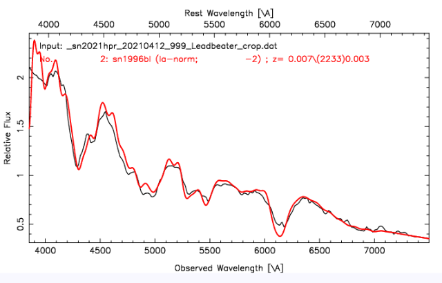

Re: AT 2021hpr
Hi Frederic,

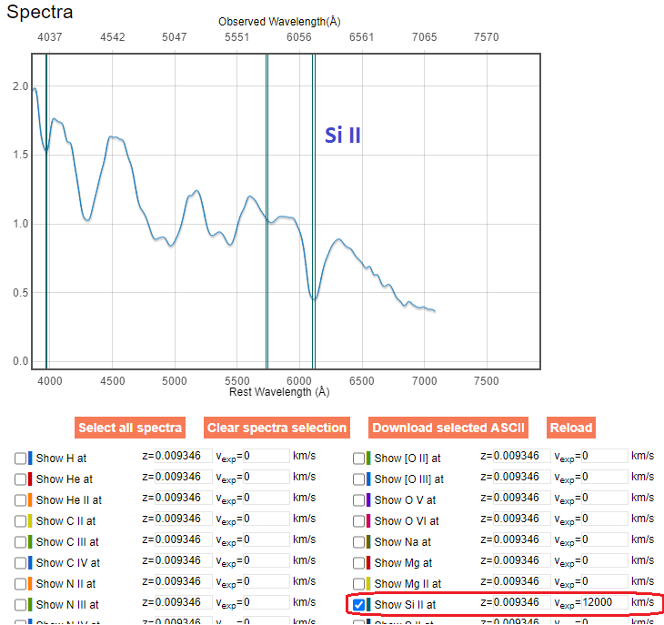

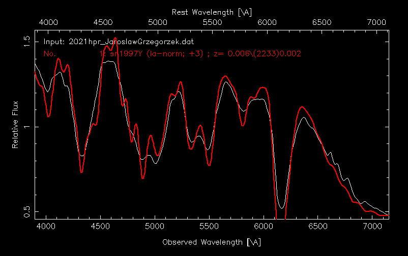

Take care when using classification programs. They are not always reliable. This is type Ia, not 1b/c
I took ALPY200 spectra of this object on 20210403 at ~mag 17(also in TNS) and 20210412 (last night) at ~mag 14.5
The strong broad SiII absorption line characteristic of type Ia supernovae is clear (at 6000A in the earlier spectrum and 6150 A now) and SNID confirms with high confidence that it is a type Ia at the host galaxy redshift from both my spectra

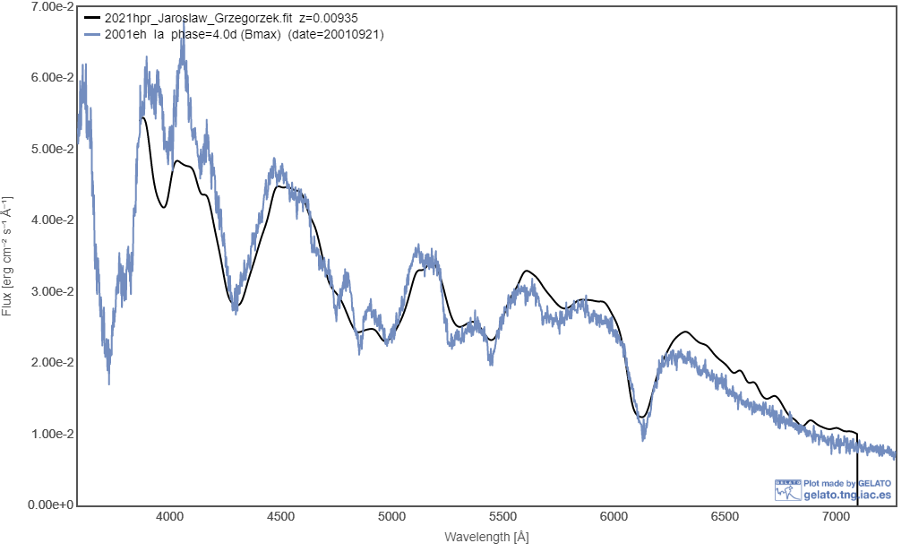

Jaroslaw Grzegorzek
Re: AT 2021hpr
Post by Jaroslaw Grzegorzek »

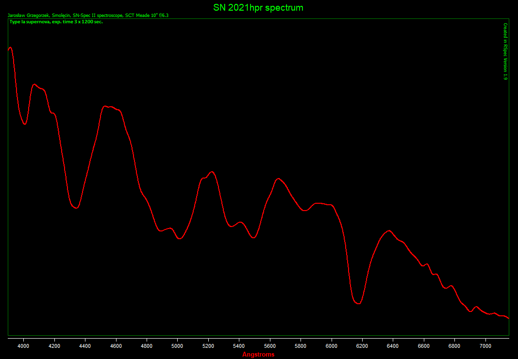

SN 2021hpr spectrum obtained using my R~100 SN-Spec spectrograph. Obs. date: 2021-04-20. Exposure: 3 x 1200 sec. Telescope: SCT Meade 10" f/6.3. Camera: Trius SX-825 mono. Software: MaxImDL+BASS+RSpec:
Jaroslaw Grzegorzek
Re: AT 2021hpr
