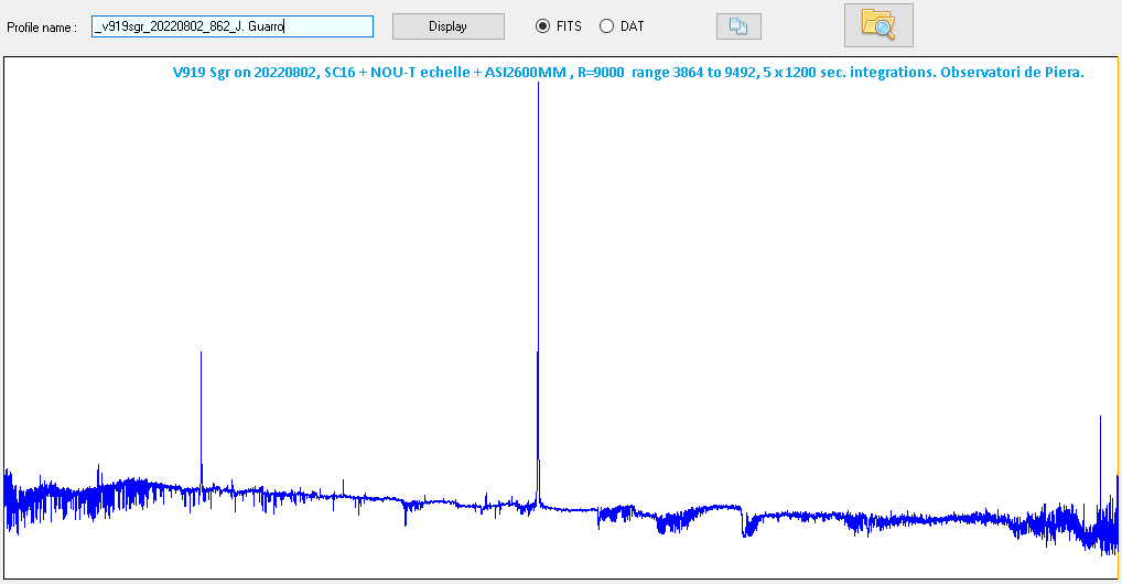

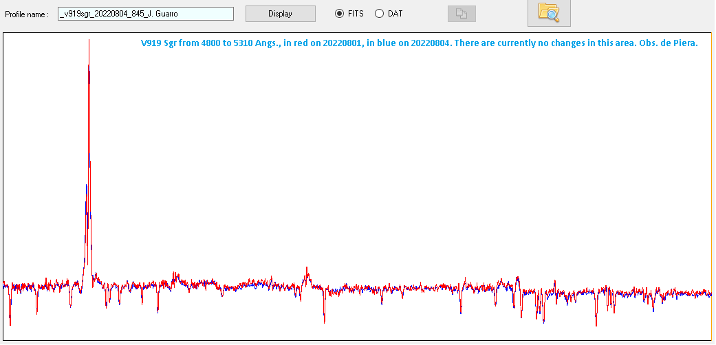

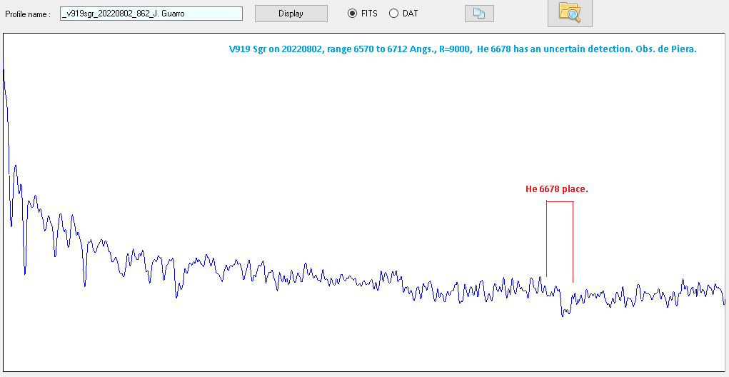

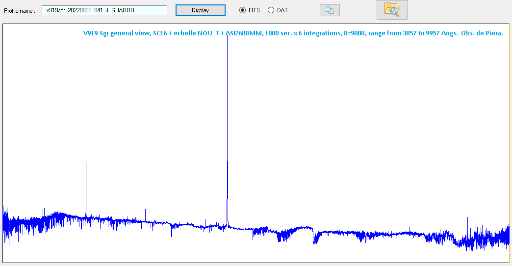

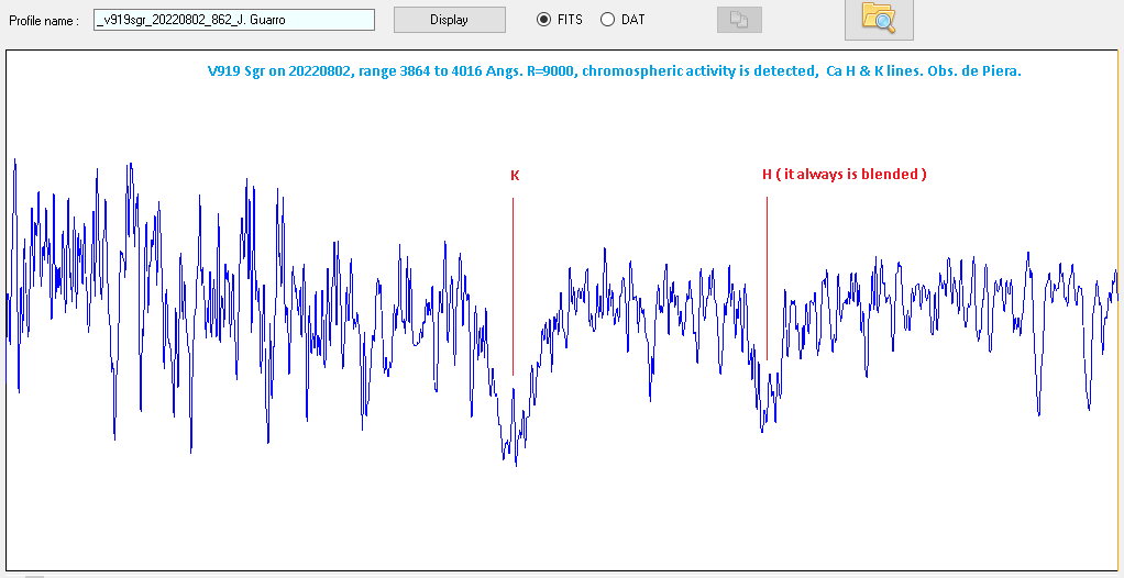

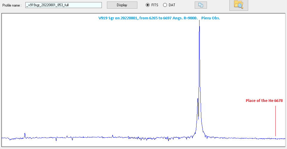

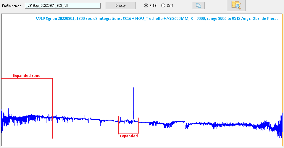

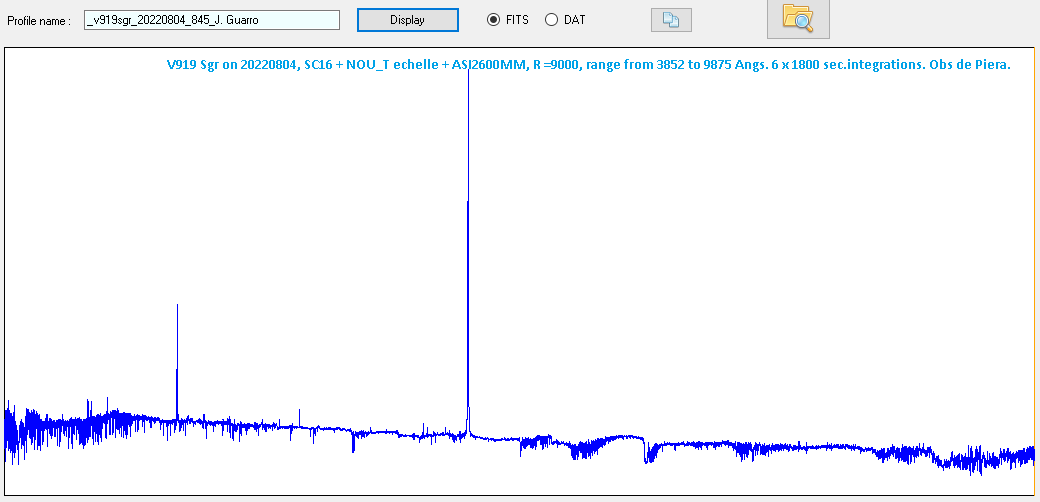

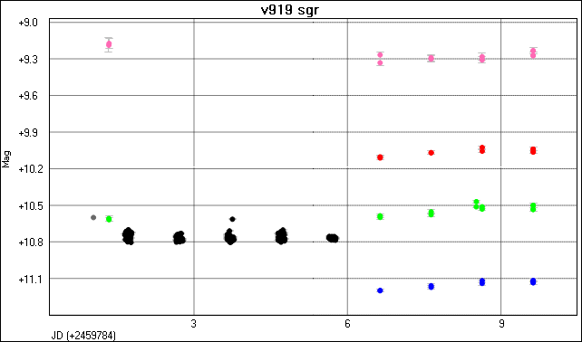

Last night I observed V919 Sgr, in bad transparency conditions and unfortunately the
clouds interrupted me on the middle observation, because my intention was to take 6 integrations in total.
But I think the result is reasonably good, so I'm going to try it again tonight.
Regards, Joan Guarro.

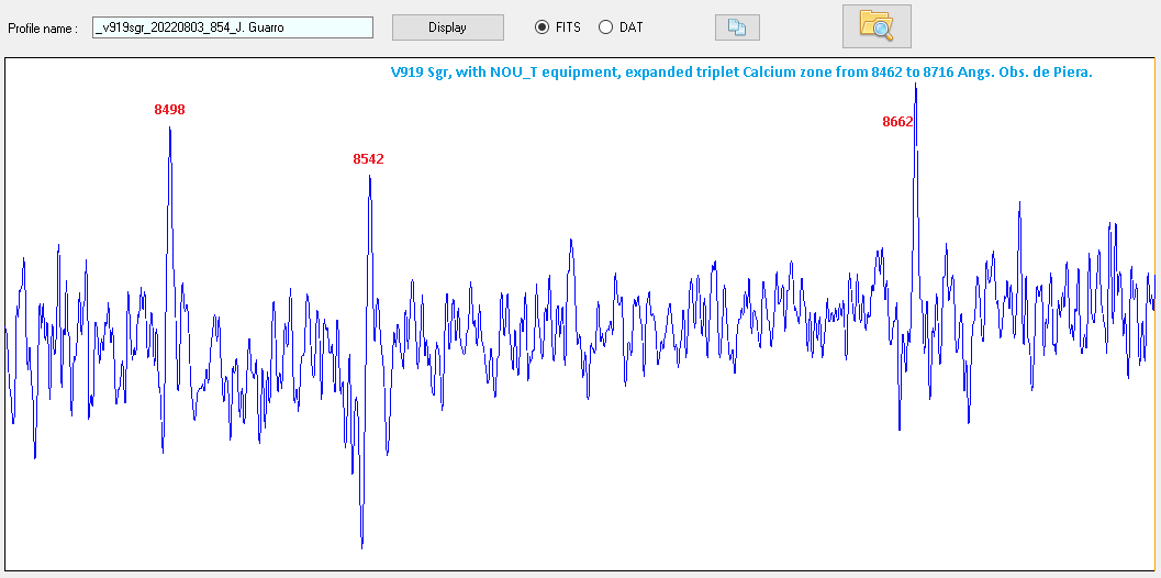

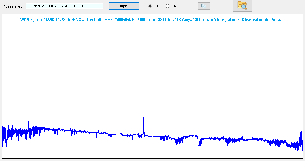

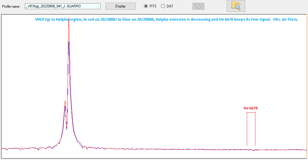

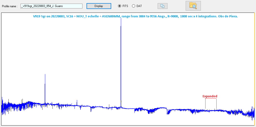

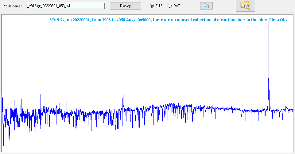

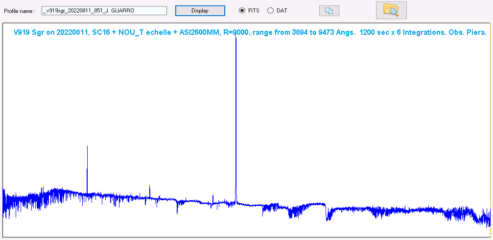

That is V919 Sgr yesterday night, the observation was taken through a SC16 telescope,a NOU_T echelle and an ASI2600MM, with a 5 integrations of 1200.
I'm really glad with the NOU_T, ( the Tim Lester echelle design ), and its equipment results.
The most curious is the chromospheric H&K activity and the quantity of absorption lines in the blue.
Cheers, Joan.

- Posts: 1562
Re: V919 Sgr in outburst
A great spectrum at Mag V ~ 10.6!
The outburst is produced by an increase of the luminosity of the hot component (envelope of the white dwarf and/or accretion disk). The mechanism is not well known.
At this state, it appears as a A-F giant/super-giant (to be precised by a detailed study of the absorption lines) which overwhelm the continuum of the cool component and its TiO bands.
See also the last spectra of BX Mon last spring.
Another good result with the NOU_T echelle equipment, this is V919 Sgr yesterday night.
Cheers, Joan Guarro.

- Posts: 731
Another NOU_T echelle observation.
V919 Sgr seems to keep its graphic without significant variations.
