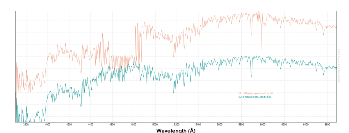

I am finding a problem with ISIS. I am observing the same star through the night and obtaining around 200 images each season.
ISIS can process all of them at the same time, but whenever i do it i always find that a bunch of spectra look weird, obviously not well extracted. I have observed this behavior several nights. Maybe about 10 or 15 of the spectra are wrong.
So i processed those weird looking spectra again, this time having only 10 images to process at the same time. In this case the extraction is good.

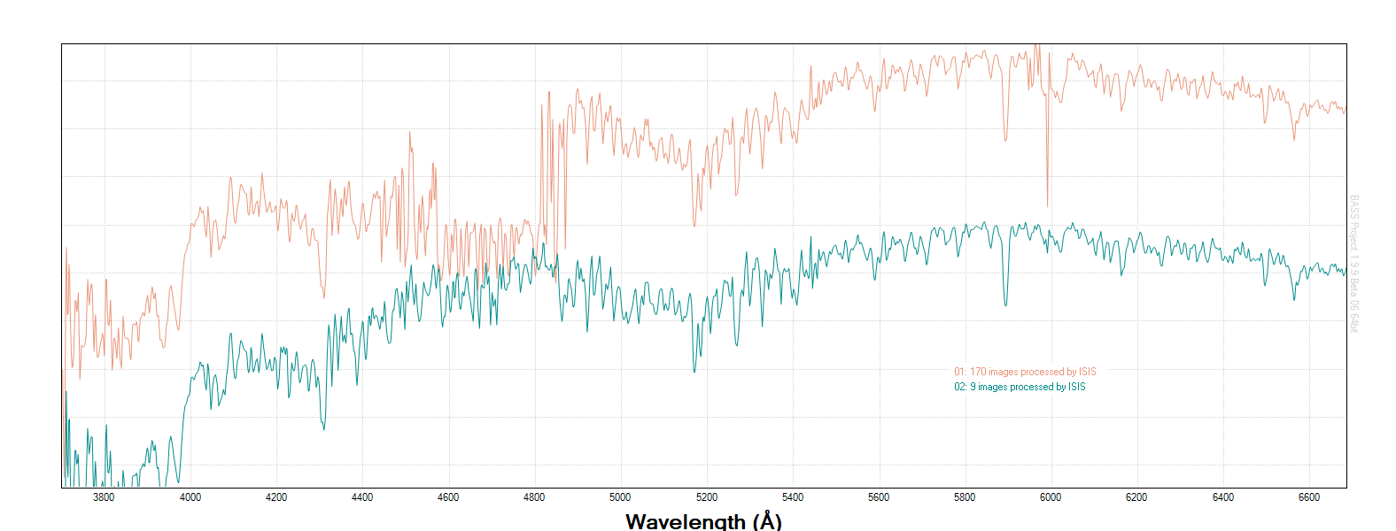

I am attaching an image to show it. In the image, the upper profile was obtained while processing 170 images at the same time. There is something not correct going on between 4600 and 4800 Angstron.
The second spectra is obtained from the same image but this time only 9 images were processed at the same time.

Anyway, i managed to solve the problem. IWhen i observed the problem, i was using a low Rejection Coefficient of 5.
When changed to a value above 25 -i tried many different values-, the process goes well.
What i do not understand is why with a low value, processing of 10 images is correct but processing of 170 is not. Is this a normal behaviour?
I forgot to mention that i am not using the Cosmic Ray filter. With it the results are worse.

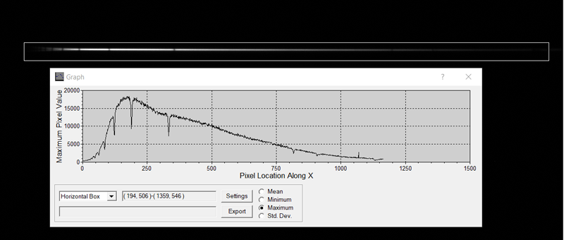

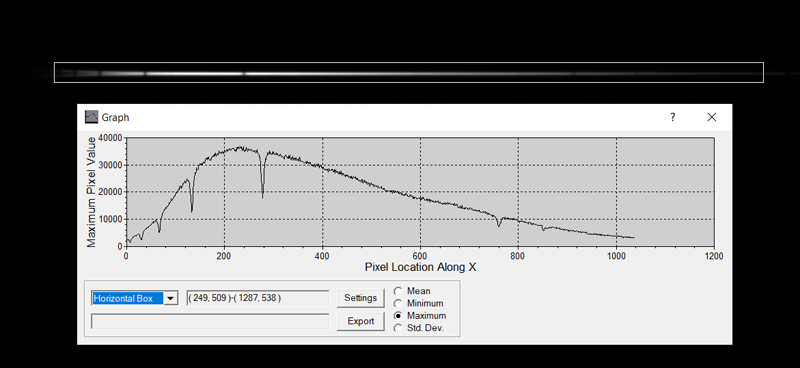

What I can say is that if the autoguiding is not perfect then you can have continuum problems that become a bit incurgent as in the following two examples.
Here I voluntarily positioned the target not correctly in the slit (with a LISA spectrograph)
and here the target is well positioned in the slit.

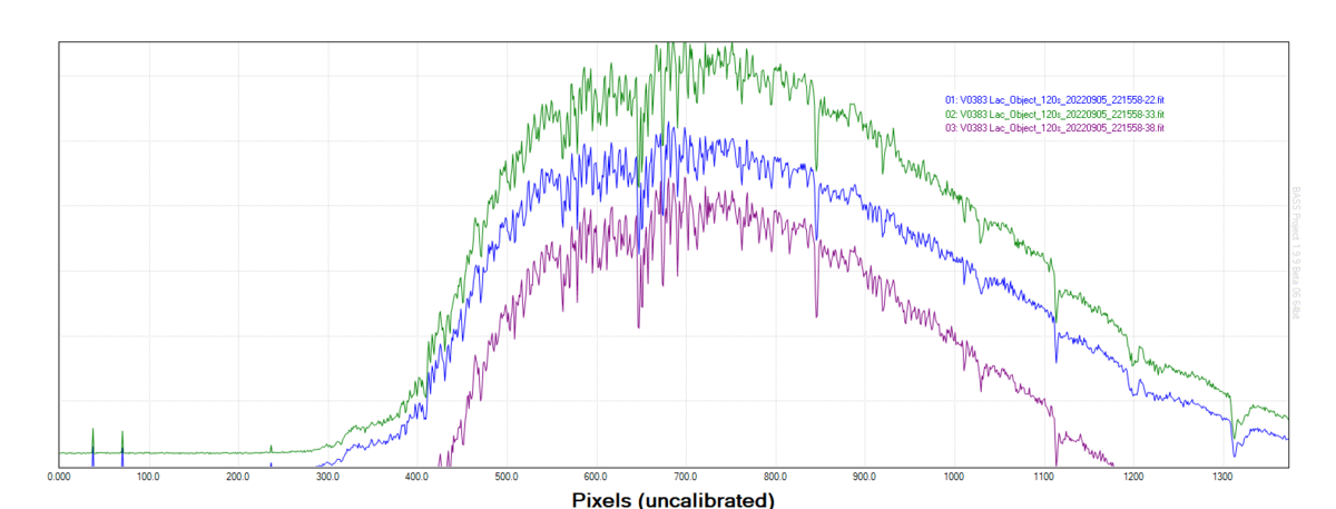

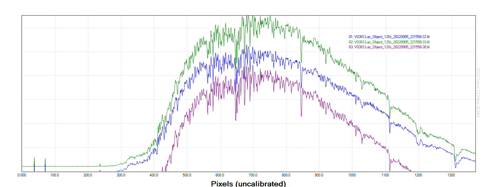

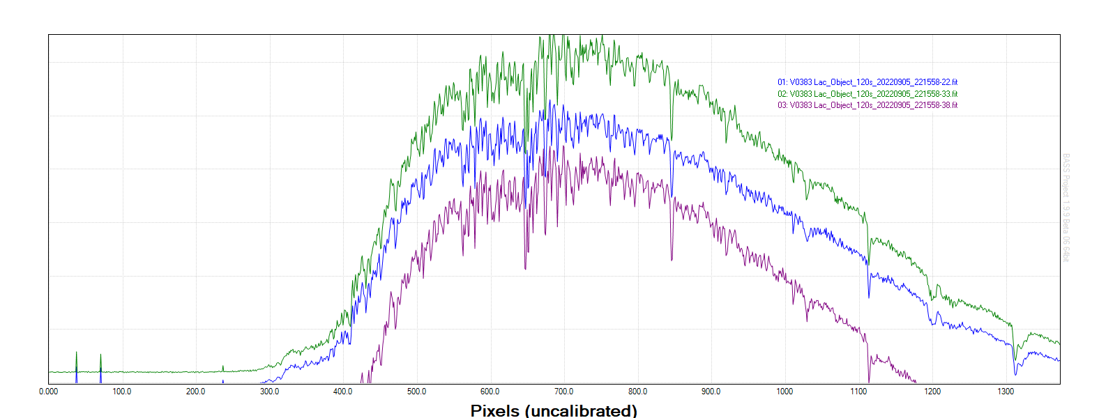

I am attcaching an image of three spectra. They are uncalibrated and without flats or darks applied. The central blue one is a spectrum that always results fine after processing. The other two, with an offset applied for clarity, result always wrong after processing all the 170 together, but fine individually or with only a few more.
In the image all three look very similar to me.
Anyway, as i wrote in the previous post, raising the rejection coefficient to 30 the result is always good for all the profiles.
