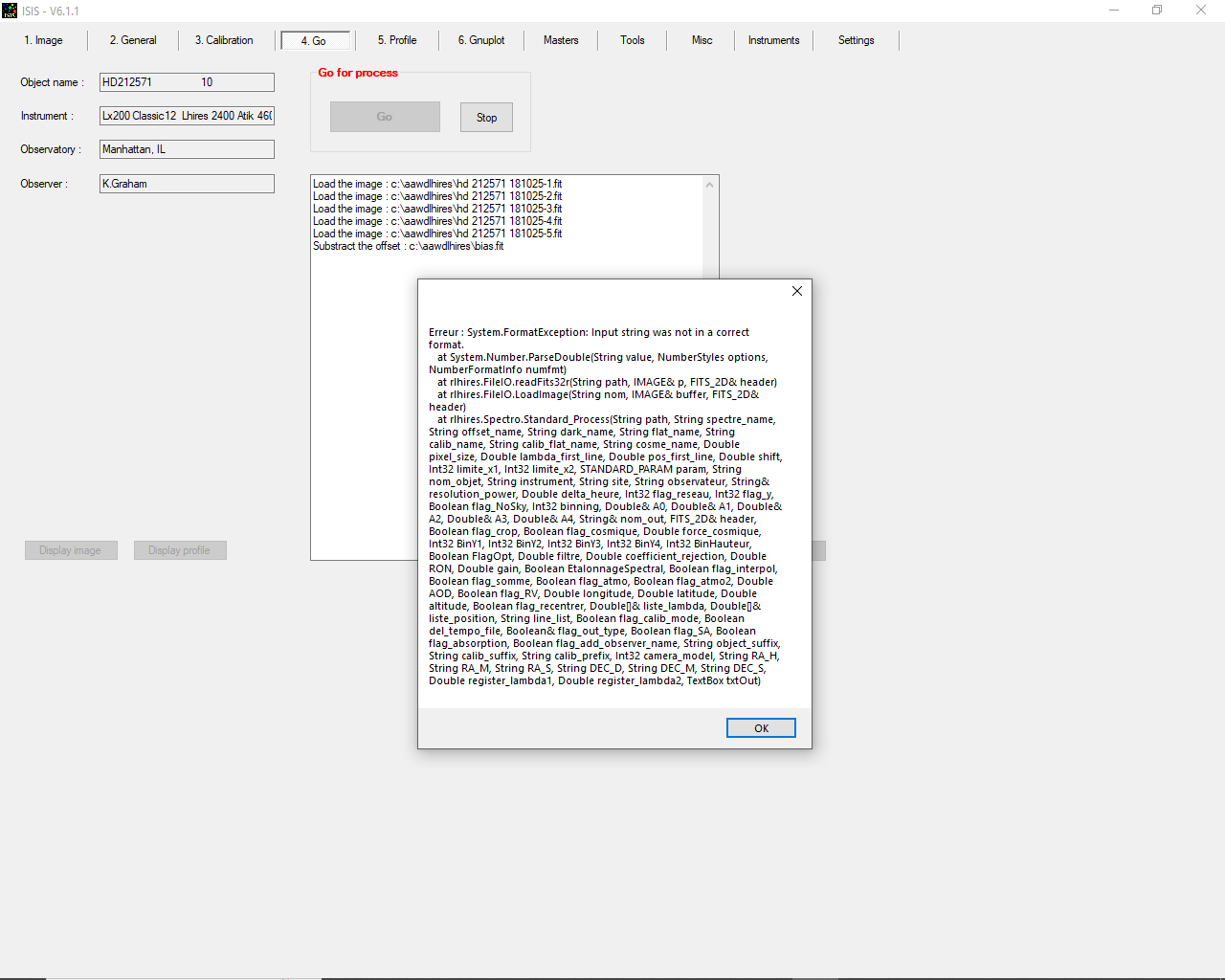

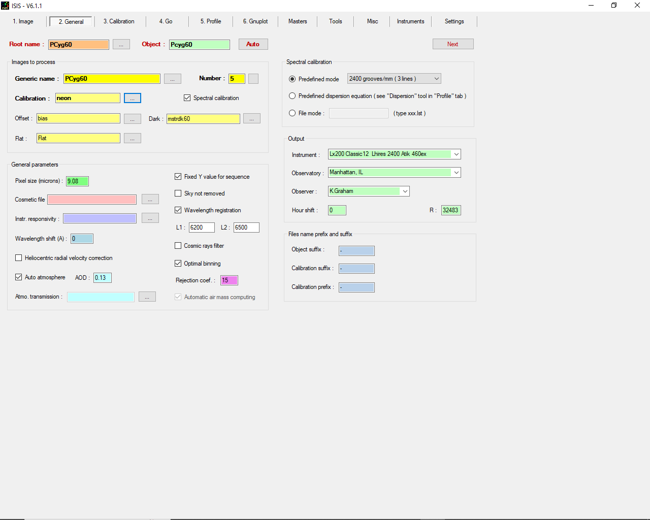

I have been away from spectroscopy for a few years and am now getting back into it. I went out last night and took some specs of P Cyg and am now trying to process them. I took darks, flats. and bias frames (8 each), created master frames for all, and placed them into a working directory.. When I tried to process them in ISIS, I keep getting an error message that I do not understand. I have attached screenshots of both the error message and the information I put in the ISIS General tab. Note how I did not include a cosme file, so I did attempt to create one in the ISIS Masters tab.from a master dark but got a similar error message telling me that the input string is not in the correct format.
I know I must be missing something as but I surely do not know what that is. Can someone please offer some advice?

Check that all images have the same pixel format
Emmanuel
