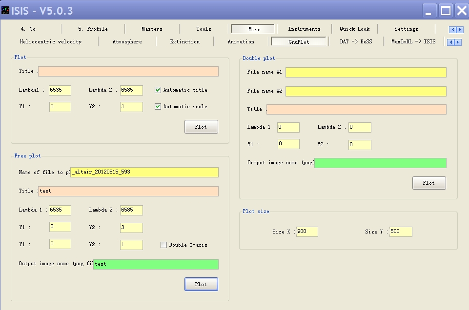

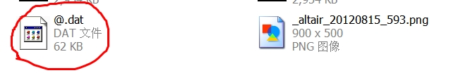

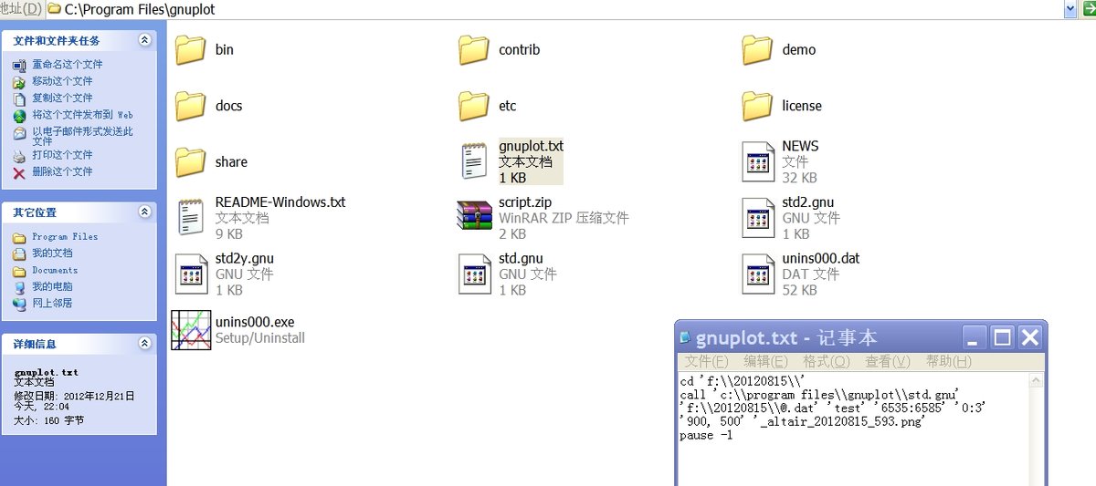

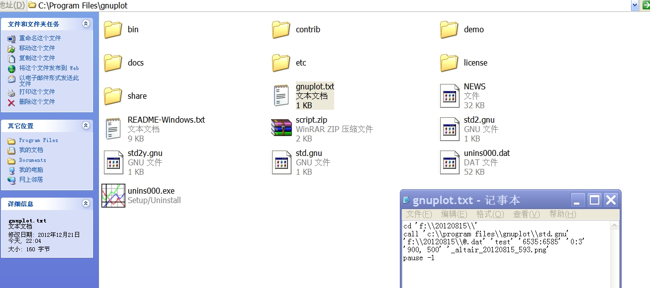

1). Tab "gnuplot" does not work. I click free plot button, nothing appears on the screen of PC,only in working directory it produces @.dat. But ISIS4.3.0 which I have ever used DOES work well and Gnuplot 4.6 works automatically after I click this button. Please see attached screenshots.
Hello Dong,
Although the instructions say you can instal gnuplot anywhere, on my system I could only get it to work when it was installed in c:/gnuplot.
Also I think the ISIS .gnu files might have been updated for version 5 So it might be worth downloading them again from here
http://www.astrosurf.com/buil/isis/gnuplot/install.htm
and reinstal them in the gnuplot folder.

Hi Robin and Dong,
what ISIS does not like is a Gnuplot directory with space such as "C:\Program Files\Gnuplot" or directories which are renamed in Windows 7, such as \mydocuments. The plotfiles std2.gnu and std2y.gnu have beeen changed for V5.
Regards, Martin

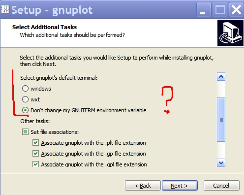

I have already downloaded ISIS 512, but I am not clear on this [please see picture]. which should I choose? My PC is Windows XP , professional version 2002, service package 3. What is WXT? :?: XT=XP?

Thank you for your help! Now I can run Gnuplot with ISIS 5.1.2.
Thank you again :) my dear teachers~~
