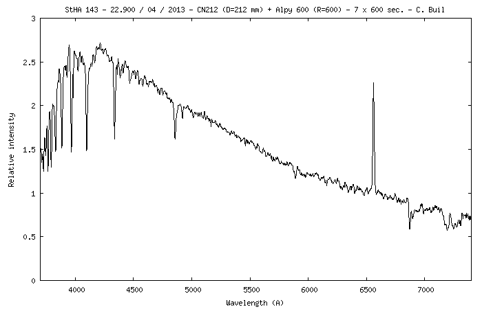

Below a faint Be star spectrum (StHA 143) at V=12.0 for the BeSS database taken with Alpy 600. It is a typical faint object, only easly accessible with
LISA/Alpy class spectrograph, for low resolution survey (note, the Halpha line profile can not be detailled, of course). I use here a modest diameter telescope, D=200 mm, but with a fast f-ratio, f/4 (CN-212 Newton telescope). The configuration is easy to use because the short focal length (sharp stellar image and easy to guide). The setup is ultraluminous for extended objet spectroscopy.
Alpy 600 can be used at f/10 but the tyoical magnitude lost relative to a f/5-f/6 configuration is 0,5 to 1 magnitude (the exact value is very dependant of seeing and the actual telescope diameter).
