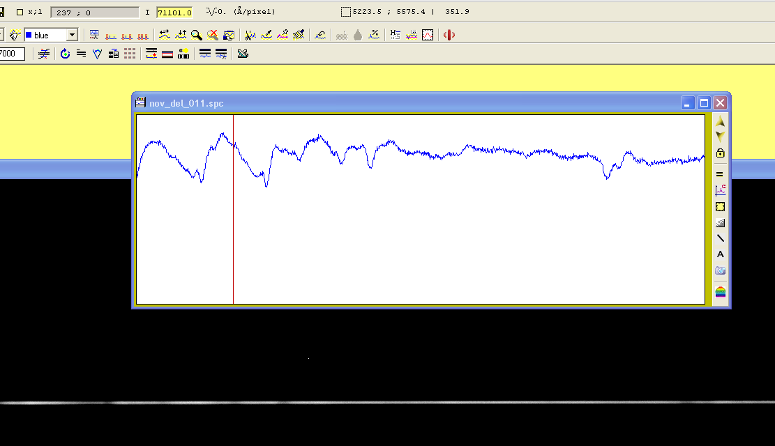

There was a small break in the clouds here for a few minutes (the first since the nova appeared) so at last I was able to take a quick spectrum (~5200-5600A with LHIRES 600 which just happened to be where I was set up last observing session for the WR campaign. It is now cloudy again but at least I can add my name to the list of observers now
- Nova_Delphini_2013_at_last.png (28.96 KiB) Viewed 15054 times
