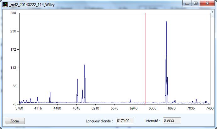

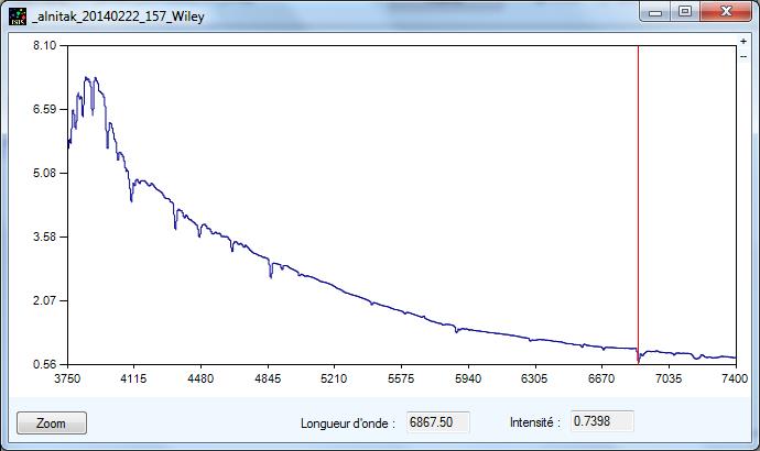

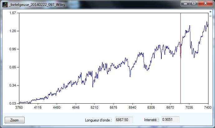

Weather cleared last night. I had to use Rigel as the reference star when (again) 52 Ori yielded images of the wrong size (all other were fine, a mystery). This permitted me to go through the entire process except telluric lines. Some profiles are attached, including my first nebula (low SNR). I am still trying to learn more about response curves, next step is to figure out telluric lines.
Critical comments most welcome,
Ed

O9.5ii
O9.5ii
21 Feb 2014
21 Feb 2014
M2i
M2i
21 Feb 2014
21 Feb 2014
My first nebula!
My first nebula!
