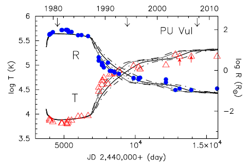

Analysis of the nova outburst
http://adsabs.harvard.edu/abs/2012ApJ...750....5K
with interesting result about Diameter (red triangles) and Temperature (blue dots)

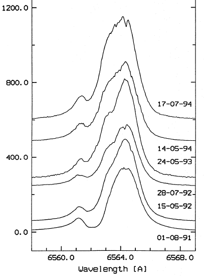

Ha profile at different dates (always strong)

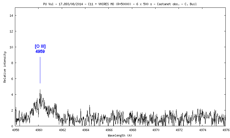

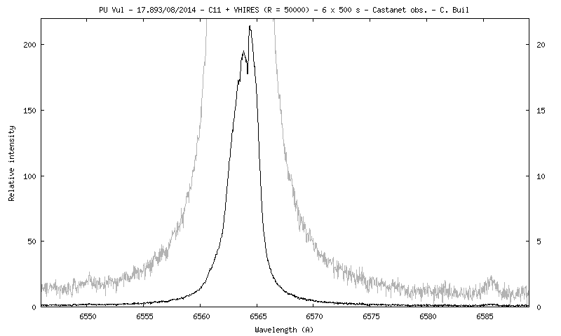

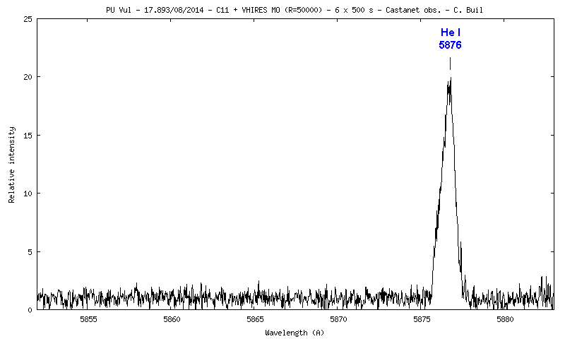

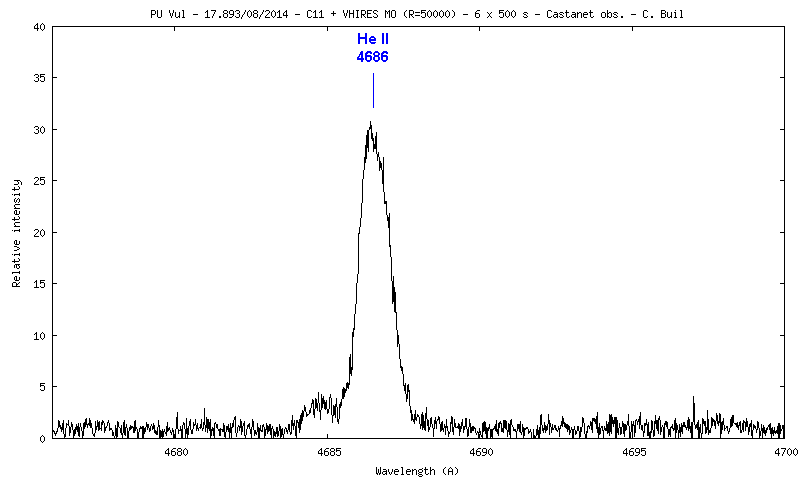

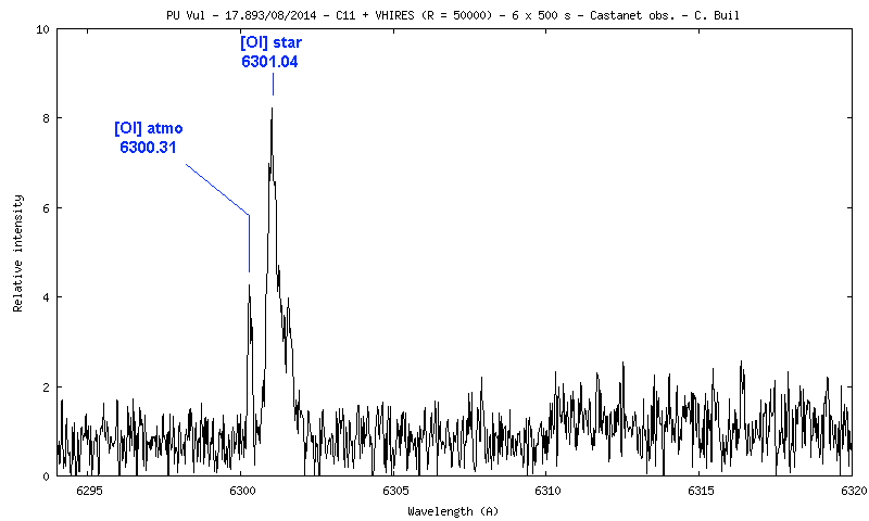

Halpha is easy to resolve (note présence if telluric lines in the shape).
Comparaison of SNR for the "faint" line at 6586 A is spectacular with Paolo and Hubert spectra.
I my spectrum the choice is very high spectral resolution (the difference between radiometric vs and spectral
resolution is well illustrated).

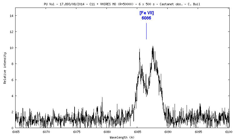

Also more lines visible in my spectrum (note presence of Fe VII).
Note redshift between atmospheric airglow [OIII] measured at 6300.306 A (compare to laboratory value of 6300.304 A -> give the precision of VHIRES for RV measure). The mean [OIII] measured on PU Vul (complex structure) is 6301.04 A (giving a possible RV for the star of +35 km/s - TBC).
