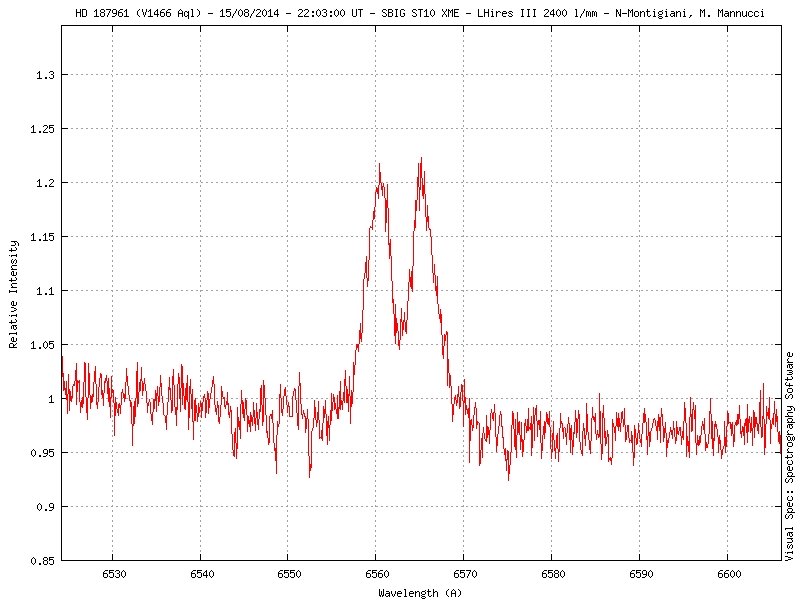

Few days ago, during some setup test of our instrumentations, we collected some spectra relevant to the star HD187961 (or V1466 Aql).
To be honest we have choosen this star from Simbad just for his confortable position in the sky. According to Simbad it is classified as Be star spectral type B7V.
As expected we have recorded a strong Halpha emission. We were curious to compare our spectrum with another one uploaded into the Bess but, big surprise :o , this star is not in the database.
Do you have any idea about the reason why it's not in the DB?
Maybe is not properly a Be star?
Hoping in your help to clarify our doubts,
Best regards

Thank for letting us know Massimiliano! Yesterday I also observed that target with Lhires III 1200. Here is the spectrum (almost identical to your but at different resolution):

Thank you Robin for your informations.
Thank you Paolo for your spectrum which confirms our observations.

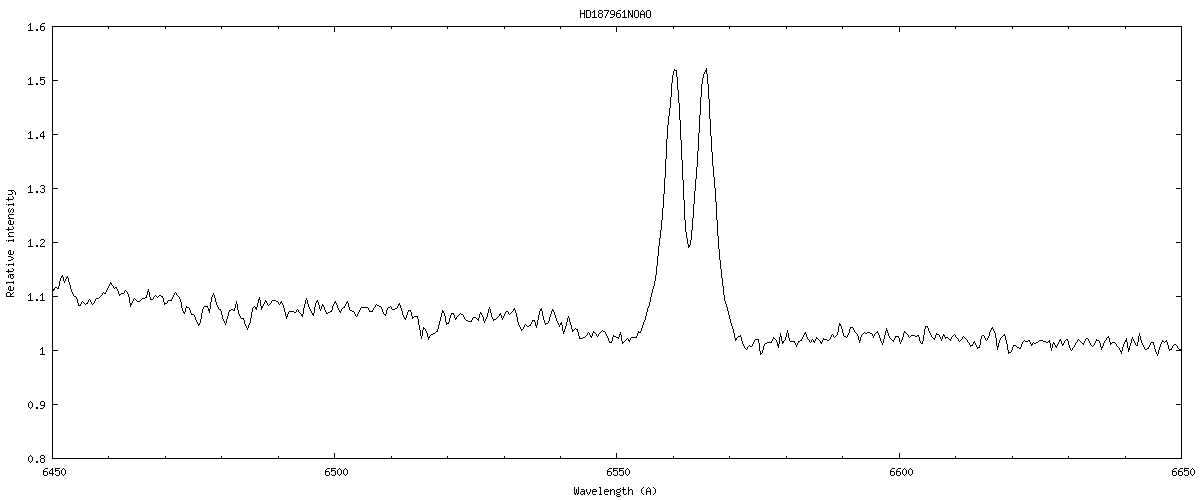

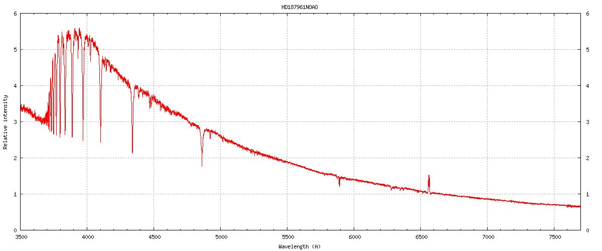

I looked up V1466 Aql on CdC and noticed that it is also a reference star in the NOAO catalog
http://www.noao.edu/cflib/
I downloaded the spectrum and converted it into a ISIS readable dat file for comparison with your spectra.
Here is the spectrum:
and a zoom-in to H-alpha:
quite similar to Paolo's and Massimiliano's spectrum :)
Apparently this has been a Be star for quite some time.
Martin

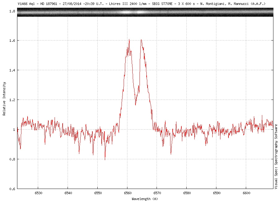

here you can see another spectrum of the star V1466 Aql
The spectrum was taken last night.
V1466 Aql - 27-08-14 - AAF.PNG (160.18 KiB) Viewed 9994 times
