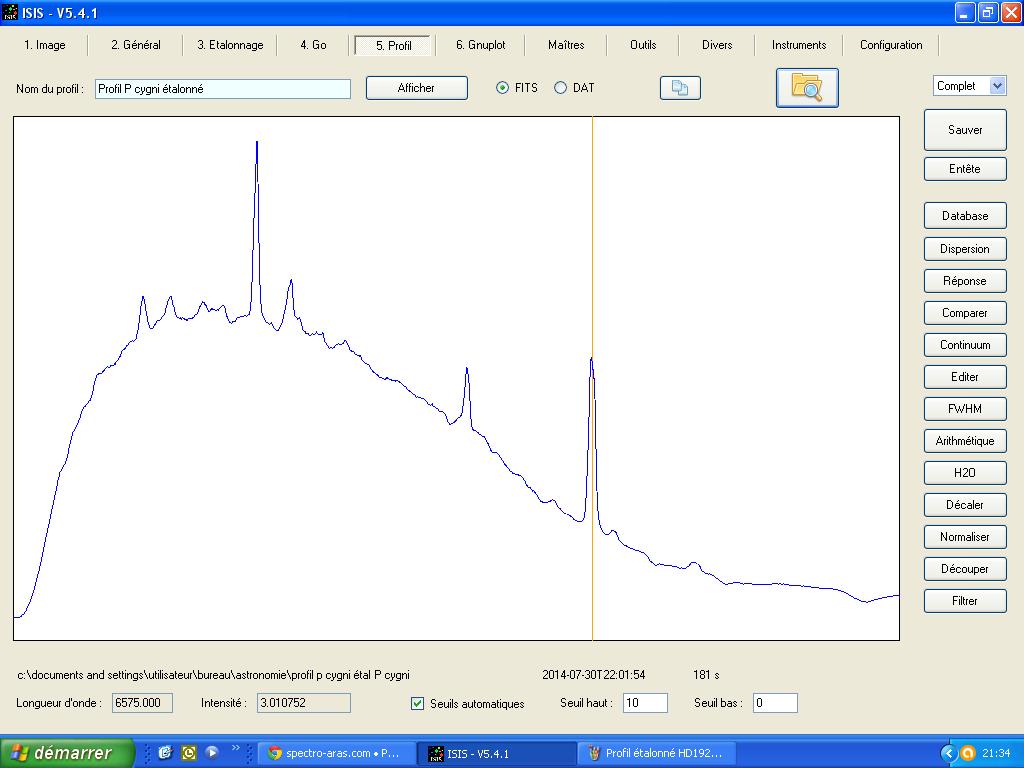

During the last OHP session, I tried to use the DSI camera (Meade)to obtain spectra of P cygni. I succeded, but the images were not usable with Isis. May be someone use this camera ?

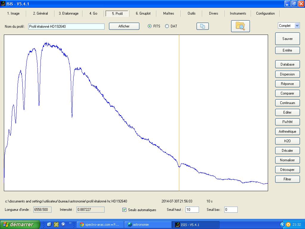

Fortunately I could use an Atik camera the last night (thanks Hubert ;) )and then obtained profiles of HD 192640 and P cygni. I think it's good for HD 192640 but I have a problem with P cygni. What do you think about this ?

Hello Vincent, with P Cygni spectrum it seems there is a problem with response calibration.
