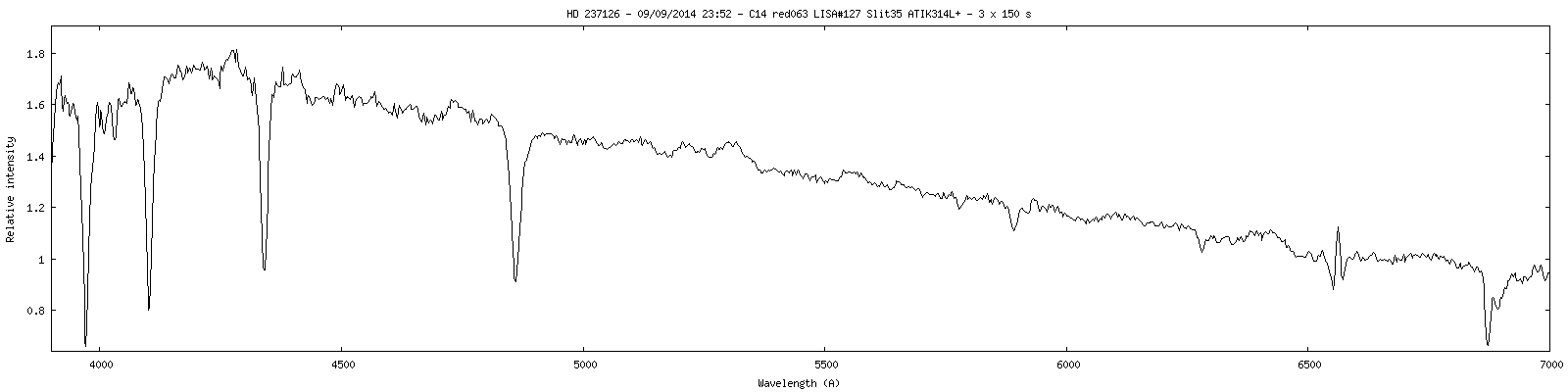

These past week i observe a few hundred of B star thanks to an automated script. I do a first visual scan of the raw image and find évident emission in Ha for 9 stars:
BD+60 133
BD+28 4177
BD+57 2581
BD+59 2675
BD+60 2523
BD+63 1964 ??? look strange...
BD+64 106
HD 237126
HR 8107
All these stars need rapid confirmation in High resolution.
Regards
Thierry
9 stars looks new Be, to be confirm in High resolution
- _bd+64106_20140925_947_Thierry Lemoult.png (7.75 KiB) Viewed 8622 times
- _hd237126_20140909_995_Thierry Lemoult.png (8.15 KiB) Viewed 8622 times
- _bd+631964_20140910_918_Thierry Lemoult.png (9.74 KiB) Viewed 8622 times
- _bd+602523_20140911_912_Thierry Lemoult.png (7.43 KiB) Viewed 8622 times
- _bd+592675_20140910_909_Thierry Lemoult.png (8.87 KiB) Viewed 8622 times
- _bd+572581_20140911_880_Thierry Lemoult.png (8.2 KiB) Viewed 8622 times
- _bd+284177_20140914_851_Thierry Lemoult.png (6.02 KiB) Viewed 8622 times
- _bd+60133_20140926_921_Thierry Lemoult.png (6.55 KiB) Viewed 8622 times

Thierry, a significant hall well done. I think BD+64 106 has been seen before as per my email but the others do not show as Be in the Catalogue of Stellar Spectral Classifications (Skiff, 2009-2014).
I doubt I will have any left to find if you proceed at this rate!

Many stars can look as Be. From my personnal data base and a long and patient bibliography research (at a time there was no Internet!), some example, nether entered in the "official" Be data base:
HD4881 (Simbad type: B9.5V):
HD5839 (Simbad type B9 (?))
HD191639 (Simbad B1V, noted Be in Simbad... but can be also a beta Cep star, ... )
I hope you have better luck. The role of Coralie Neiner is important for analysis and confirmation.
But already, an essential first step is accomplished: the detection of suspected cases (and compilation of
a public list for reseach and more observations). Perfect.
(PS: it's clear the aspect of BD+69 1969 spectrum seem very different of a A or B type star).
