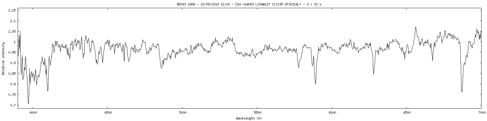

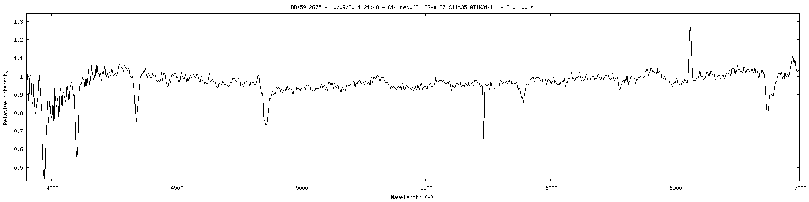

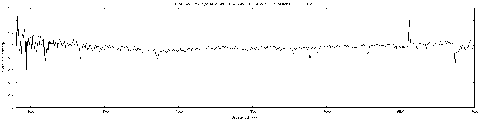

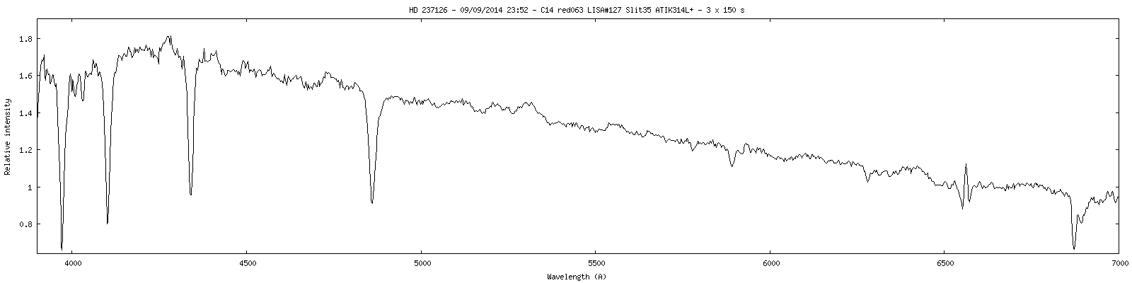

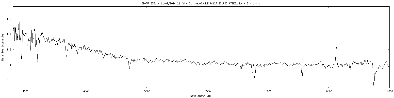

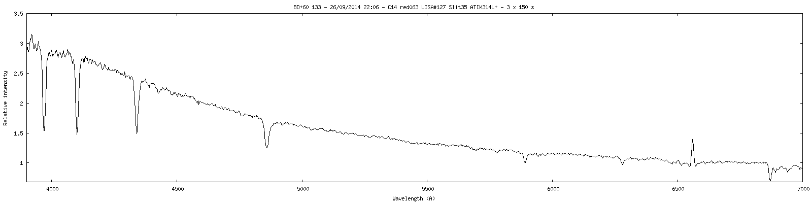

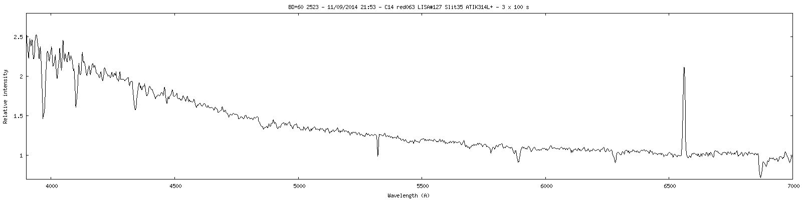

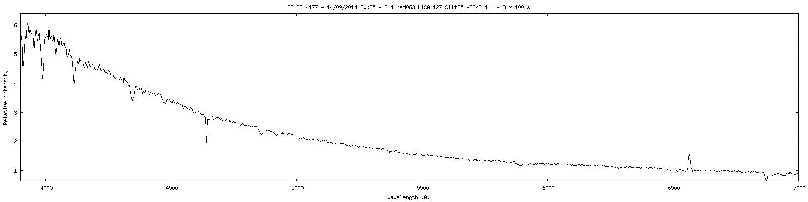

These past week i observe a few hundred of B star tnaks to a automated script. I do a first visual scan of the raw image and find évident emission in Ha for 9 stars:
BD+60 133
BD+28 4177
BD+57 2581
BD+59 2675
BD+60 2523
BD+63 1964 ??? look strange...
BD+64 106
HD 237126
HR 8107
All these stars need rapid confirmation in High resolution.
Regards
Thierry
9 stars looks new Be, to be confirm in High resolution
Thierry Lemoult
- Posts: 136
- _bd+64106_20140925_947_Thierry Lemoult.png (7.75 KiB) Viewed 15308 times
- _hd237126_20140909_995_Thierry Lemoult.png (8.15 KiB) Viewed 15308 times
- _bd+631964_20140910_918_Thierry Lemoult.png (9.74 KiB) Viewed 15308 times
- _bd+602523_20140911_912_Thierry Lemoult.png (7.43 KiB) Viewed 15308 times
- _bd+592675_20140910_909_Thierry Lemoult.png (8.87 KiB) Viewed 15308 times
- _bd+572581_20140911_880_Thierry Lemoult.png (8.2 KiB) Viewed 15308 times
- _bd+284177_20140914_851_Thierry Lemoult.png (6.02 KiB) Viewed 15308 times
- _bd+60133_20140926_921_Thierry Lemoult.png (6.55 KiB) Viewed 15308 times

High resolution Halpha spectrum of some of Thierry suspected Be stars. Not so easy with a resolution of R = 50000 (nearly 100 time the Thierry original survey resolution), a relatively small telescope (C11) and a fiber link to the telescope (VHIRES-MO). Thierry, your stars are not so bright
BD+28 4177 (evident double peak emission):
BD+60 133 (very similar to an edge on disk):
BD+60 2523 (most intense peak of the sequence):
BD+64 106 (V = 10.2 and relatively short exposure - nearly the limit magnitude of this setup (but bad seeing and some wind)):
HD237126 (most faintest Halpha emission of the sequence - sound like a Be stars..)

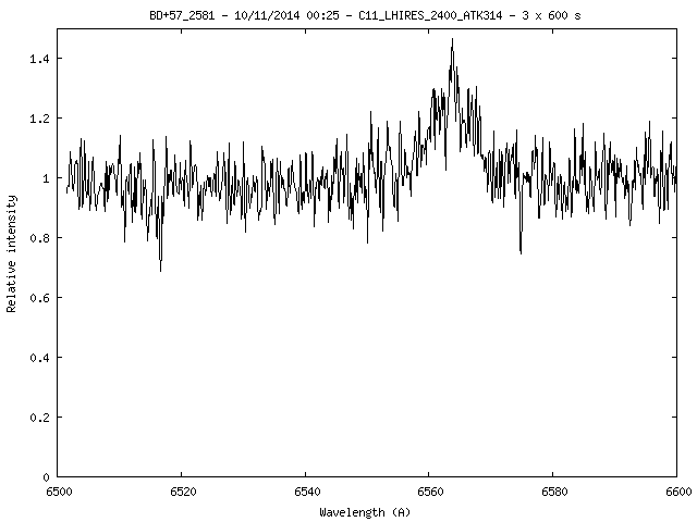

Re: 9 stars looks new Be, to be confirm in High resolution
BD+57 2581 emission confirmed at high resolution (short observation during gap in clouds so poor SNR)
Hi Thierry, I observed BD+59 2675 with Lhires III 2400 (R~15000) and can confirm an emission line "bottle" shaped.
