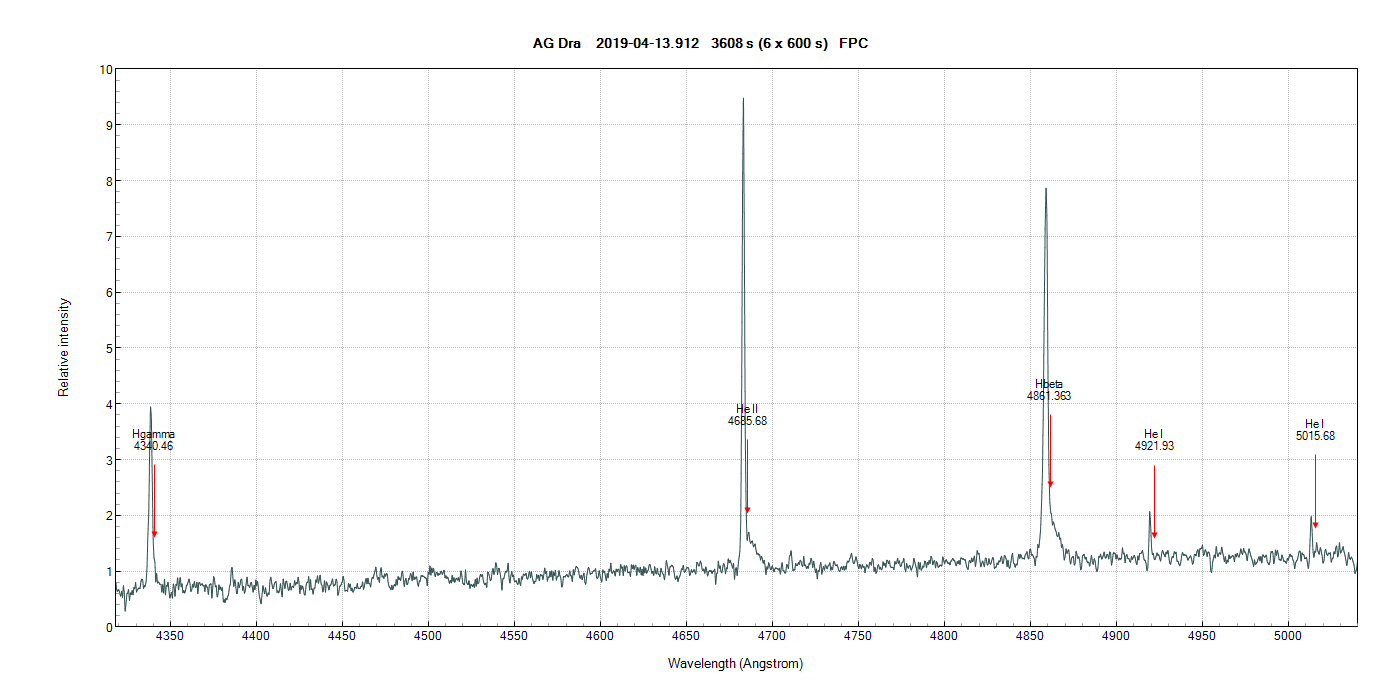

- Posts: 88
here is my contribution from the last night, taken with the DADOS and the 1200 l/mm grating. I'm not sure if these spectra will be useful or not, because the resolution is about R=4000. Plus, I'm a bit worried about lambda calibration: it seems that the bands are a bit shifted from the expected position... or maybe it is a peculiarity of AG Dra? These spectra have already been corrected by heliocentric speed by ISIS...
Well... if resolution is not enough, I would come back to low-resolution...
Greetings,
Fran
Greetings,
Fran
- Posts: 1523
Hi Fran,
The systemic velocity is very high: -147.7 km/s (2.39 A at 4861 A)
The problem is the shape of the red edge of H beta and HeII (the "bump" is an artifact)
See e.g. Peter's spectra (R = 2500) in the database. http://www.astrosurf.com/aras/Aras_Data ... /AGDra.htm
or at R = 11000
(match well!)
At date, no sign of outburst
Let's go on. Excellent coverage for the baseline
