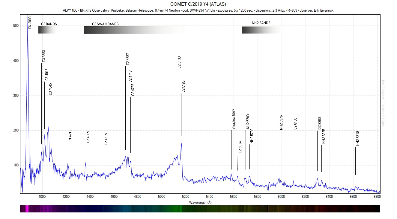

Here my attempt to record the spectrum of comet C/2019 Y4, with an ALPY600. The exposure was 5 x1200 sec. data reduction with BASS software.
