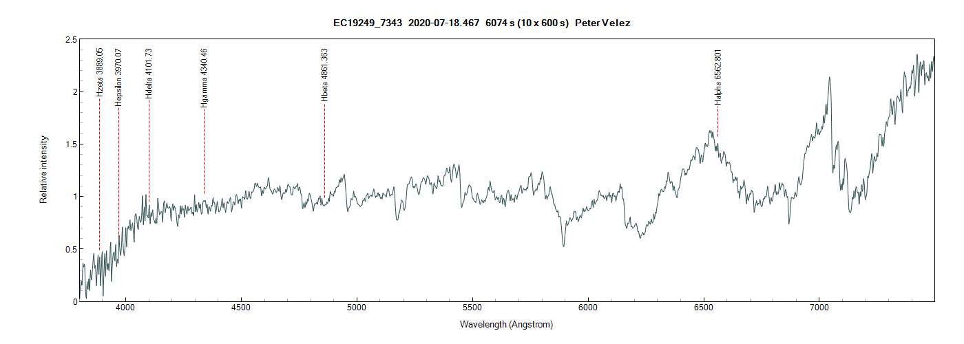

Here are my spectra for southern targets Hen 4-204 and EC 19249-7343.
Please treat these as provisional - I had limited time last night and want to check that I imaged the correct stars.
Balmer emissions are very modest, if present at all, in both stars. Emissions are most pronounced for H gamma.
Francois, I have corrected these for HRV (determined in ISIS when processed) and V reported in Simbad. Do you want the spectra provided with or without these adjustments?
Pete
Pete
