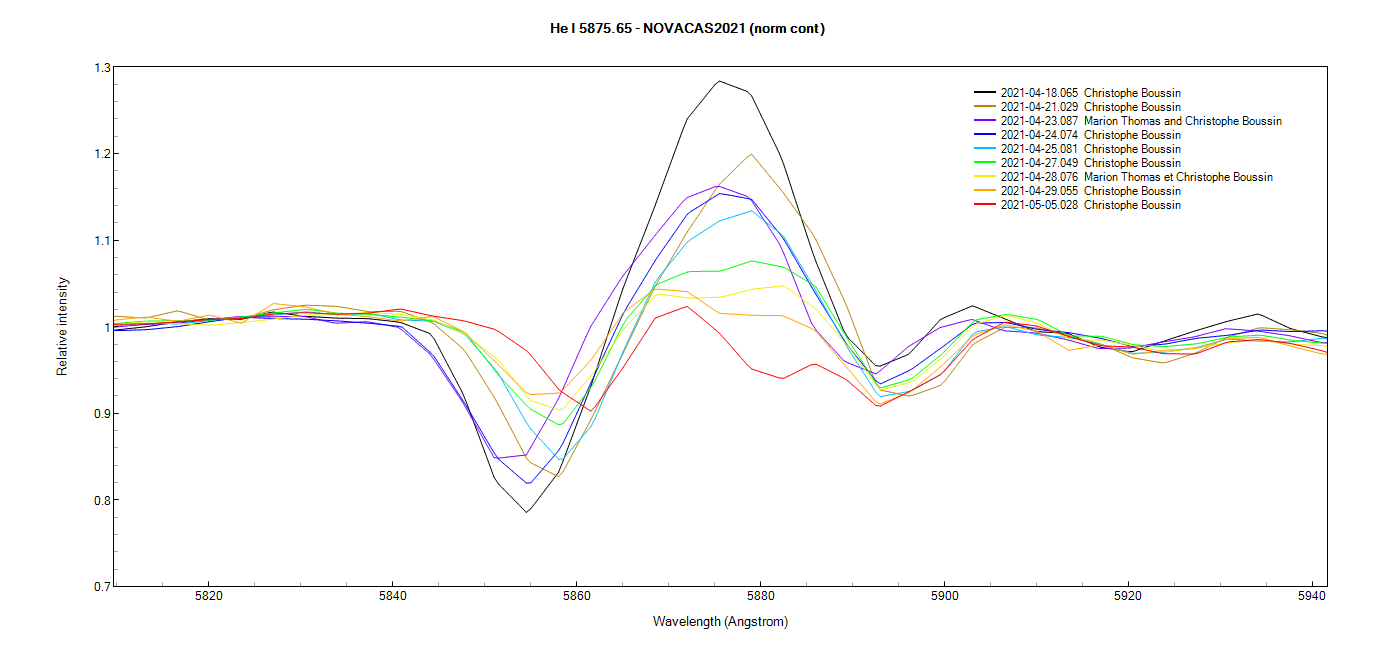

The relative intensities of HeI lines continue to decrease...
Evolution of the HeI line at 5876A (for example) between April 18 and 29 :
He I line at 5876A on April 18th, 21th, 23th, 24th, 25th, 27th, 28 and 29th 2021(zoom)
Evolution of the HeI line at 5876A (for example) :
He I line at 5876A on April 18th, 21th, 23th,24th, 25th, 27th, 28th, 29 th and May 5th 2021(zoom)
