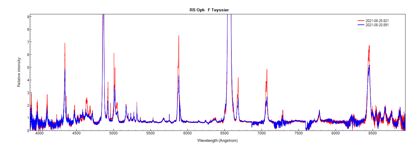

[NII] 5755, formed in the symbiotic nebula is declining relative to the continuum since Aug. 17.5
Day 16 after max.
An important milestone in the development of the spectrum: the appearence of high ionized lines in the ejecta.
NIII and He II
[Fe VII] is now obvious
[OIII] in the symbiotic nebula still raising according to the continuum
While EW([NII]) is stable at ~0.45
Now, waiting for very high ionized lines during the next month.

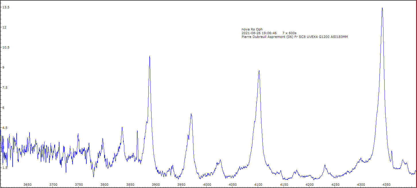

Post by Dubreuil Pierre »
Bonjour
Région UV avec spectrographe UVEX(4)
G1200 slit 23µ
La magnitude semble avoir diminué .
Spectre zone UV
Spectre Nova Rs Oph
Spectre Nova Rs Oph

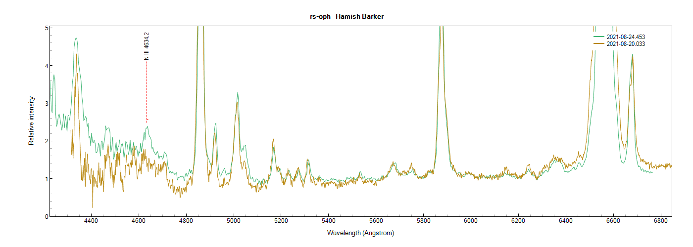

Low resolution with the L200 / 180lpmm grating from a few days ago (24. August). it's raining cats and dogs today!
