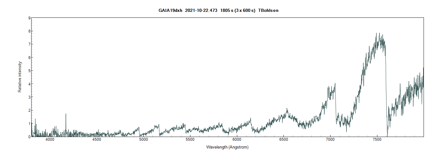

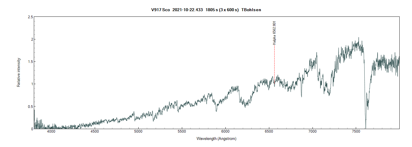

- Posts: 191
I have also tried a couple of these targets. Most set soon after dark so will not really be observable until next season. I took spectra of V917 Sco and Gaia19dxh.
V917 Sco shows a K type star with a small Ha absorption.
Gaia10dxh is a M star with no emission lines as Paolo also found. I will send them to ARAS also.
Terry
Terry

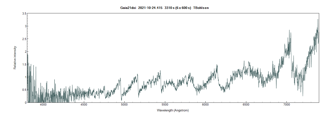

- Posts: 191
Hi All
another star from the list.
Gaia21dxi. Looks like a late K or M star to me with no emission or unexpected absorptions. It is a bit nosy as it was only 20deg above the horizon when I finished.
Terry
Terry
