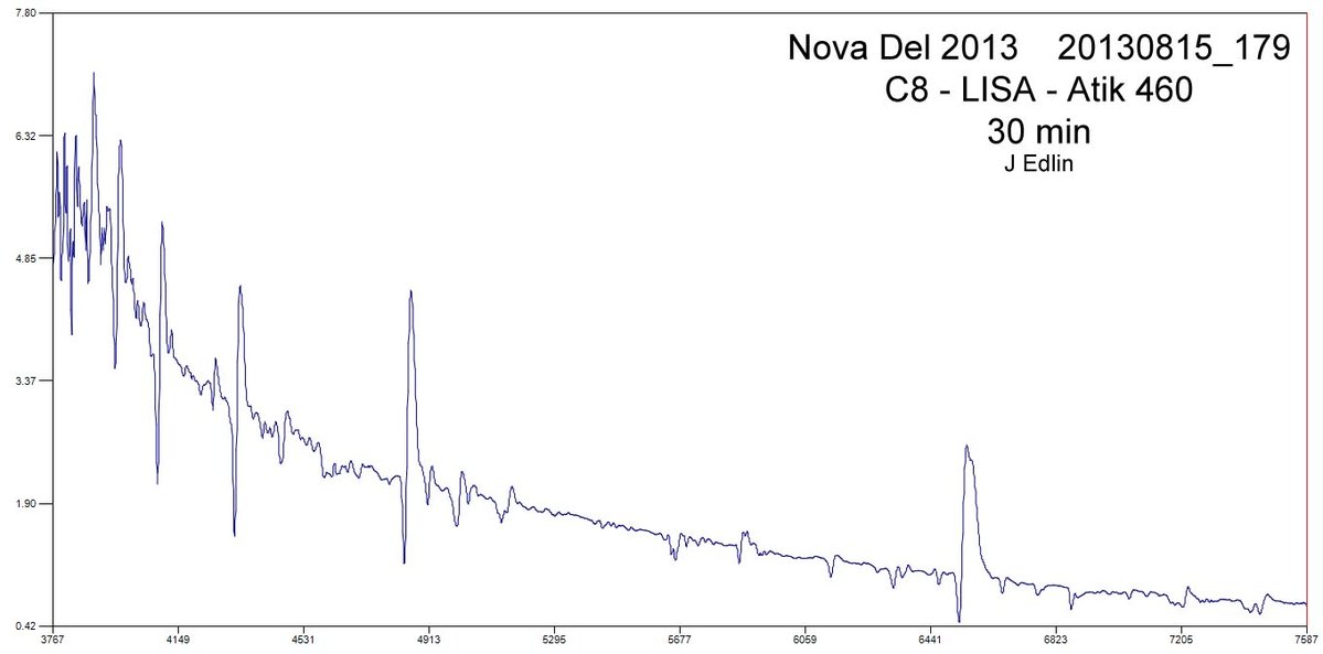

I made an attempt at the new Nova Del 2013 tonight under very thich haze. Could hardly see the star Altair while imaging the nova. I took 30 minutes with LISA and Atik 460 through a C8 telescope. This is what I got. I am not sure how accurate the continunm is given the very bad transparency. I will try another night when much more clear.
Jim E

Posts: 13
Joined: Mon Oct 10, 2011 3:22 am
Post by James Edlin »
Sorry this hopefully is the correct image.
Jim
Posts: 578
Excellent spectra!
