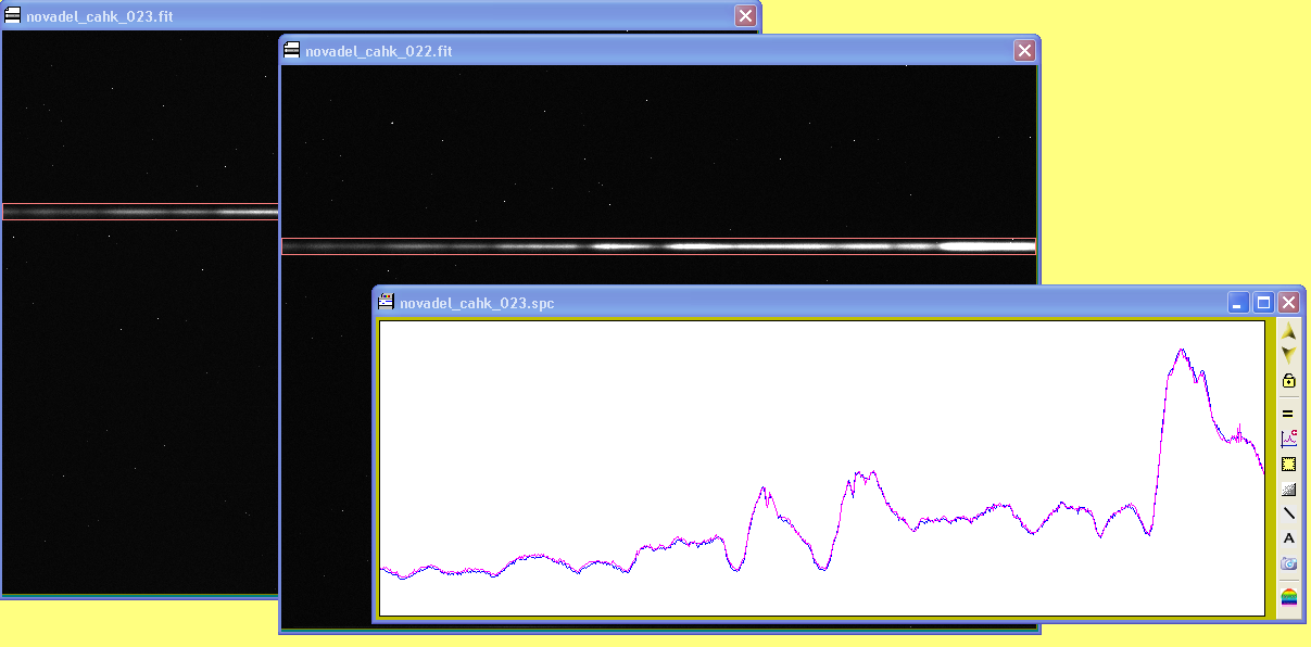

Je viens enfin de réussir à traiter mon image des raies H&K du calcium. Ca a pas été simple car j'ai pas trop l'habitude de ce coin là du spectre, mon signal était assez faible et la calibration a été délicate.
Bref, après avoir utilisé tous les logiciels possibles, j'ai réussi à obtenir quelque chose de cohérent à la fois dans VisualSpec, SPCAudace et ISIS (j'ai même ressorti un vieux SPIris de derrière les fagots...)
Ce soir, ici, c'est couvert ; j'attendrai lundi au mieux pour remettre cette expérience. Le télescope est resté dans la configuration de vendredi, ça devrait aller mieux mais je monterai le temps de pose.
I have just finish to process my image of H & K lines. It was a bit hard for me because it is the first time I went to that corner of the spectrum, my signal was quite weak and the calibration was perilous.
Anyway, I got something coherent in both VisualSpec, SPCAudace and ISIS (and a good old SPIris from an old hard disk ...)
The forecast is bad between Bordeaux and Cognac for two days. I will wait for Monday. The telescope remains in the configuration of Friday, it should be better but I surely have to push the exposure time.

Eric, you capture CN emission at 3886A? This night, with Lhires III 600 it seems not visible...
Someone can confirm?
Ciao
Posts: 1432
Eric, very important. Evaluate your 2D and look if the feature near 3880 A is real (a cosmic rays, ...).
Presently, from Toulouse and on only one 300 sec. cloudy exposure (!) near H&K with eShel I detect anything.
Posts: 1955
Nothing there tonight.

Eric Barbotin
Posts: 35
Joined: Wed Jun 05, 2013 7:48 pm
Post by Eric Barbotin »
Hello, Ive check the 2D image and all the individuals frames ; it's a cosmic...
Eric
