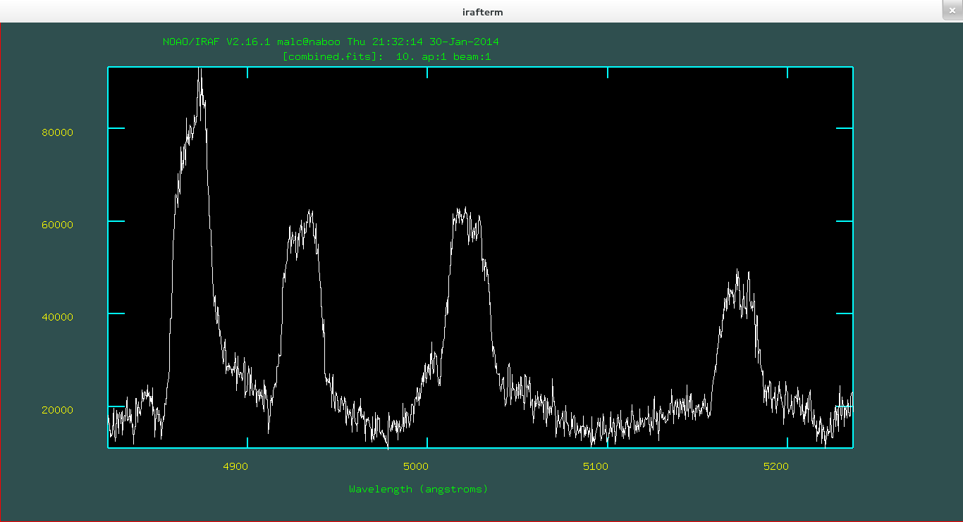

Some belated results from the 27th Jan. Terribly noisy I'm afraid. Still no guiding and I tried to narrow the slit gap slightly which made things worse, plus battling with various other technical issues. Shame as it was an incredible night down here, best we've had in months.
Close up of Hb an the FeII lines.

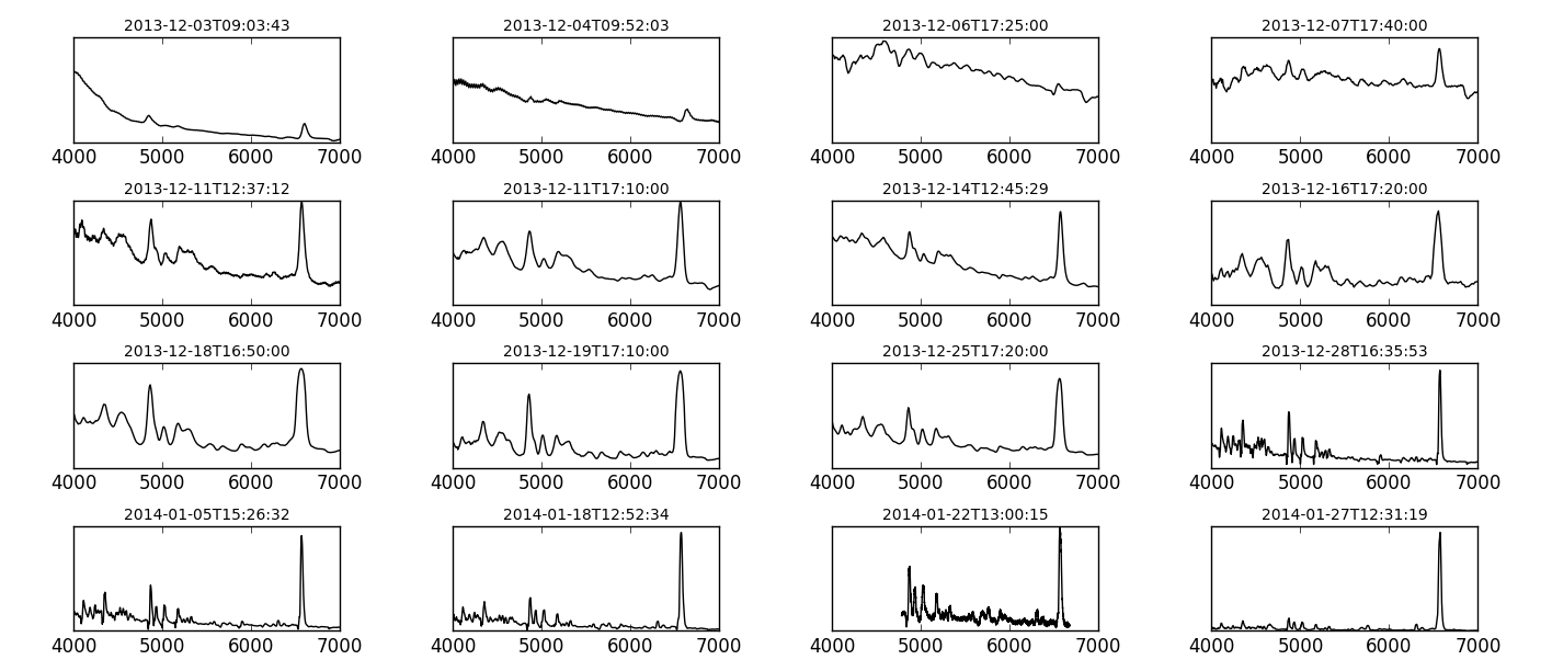

Post by Malcolm Locke »
Finally got around to writing a python script to plot a grid of spectra. Here's all of the low / medium resolution spectra for the nova that are present in the ARAS database. Spectra are from myself, Jonathan Powles and Terry Bohlsen.
