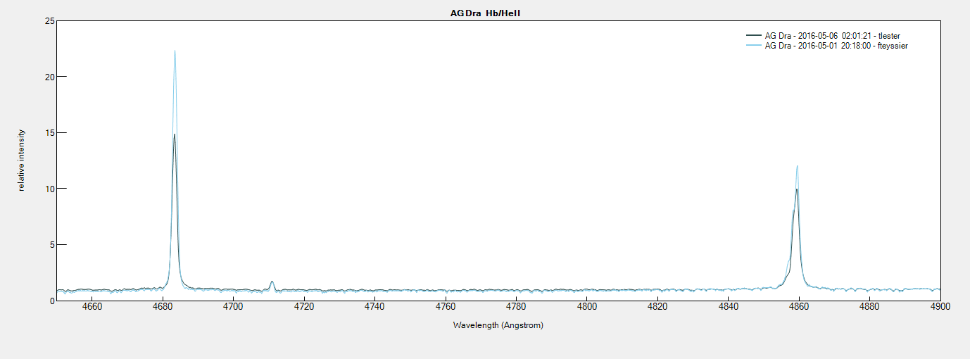

Here is AG Dra for May 6th at Hb and Ha.
Hb/HeII compared to fteyssier's result on May 1st. Shows the fairly rapid drop in ratio and line intensities.
Posts: 1565
Re: AG Dra brightening
Interesting, Tim !
You took it just during a second peak
Unfortunatly, we have poor coverage of this second event.
