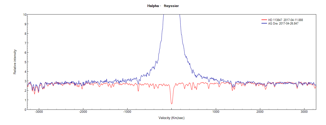

Heres's a commented spectrum,
And a comparison with a K1III star (HD 11387)
HD 113847 has been shifted by +19.81 km/s (rv = -19.91 km/s - Simbad)
and AG Dra by 149.6 km/s (from a measure of the rv of the yellow giant of AG Dra for this date)
(Spectrum obtained on April, 26th
H alpha range
H alpha line
One can see the large extension of the line, over 1000 km/s

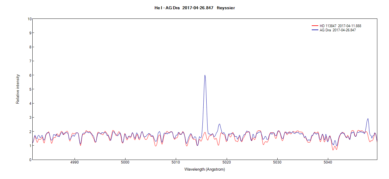

He I 5016 range
The faint lines appears clearly:He I 5048 and perhaps Fe II 5018
