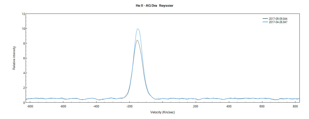

AG Dra last night
The faint absorption in the blue adge of H alpha is increasing. Can be en affect of orbital motion
He II intensity is decreasing François

Comments by Jaroslav Merc:
I measured the equivalent widths of the selected emission spectral lines from these two spectra (April 26 and May 9).
These results confirms the significant decrease of EWs of He II (-15%) and O VI 6825 (-13%). There is a less prominent descrease of EWs of He I 6678 (-6%), O VI 7082 (-6%) and Hbeta (-4%). There is also a small increase of EW of Halpha (+2%).
I have also calculated the ratio of the equivalent widths of lines He II and Hbeta which can be a good proxy to the temperature of the white dwarf and this ratio decreased from 0.87 (about 183 000 K) to 0.76 (about 174 000 K). Next evolution of AG Dra could be very interesting.
So, more data are needed! (subject to weather)
