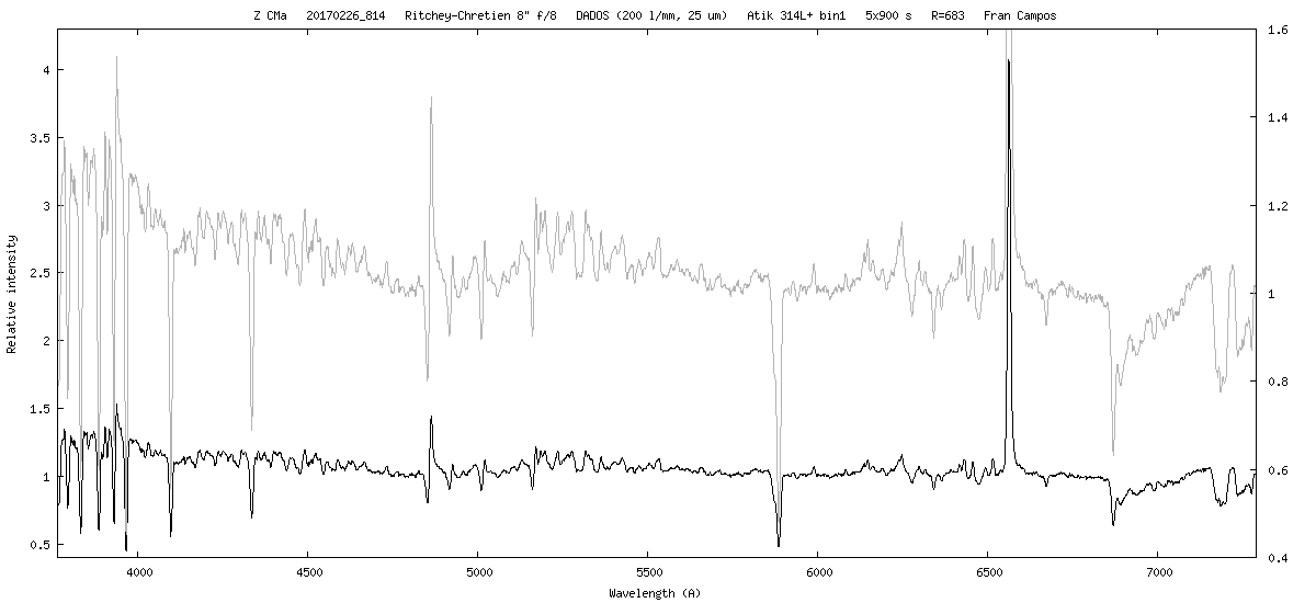

in the AAVSO forum there is an alert about a new outburst of Z CMa (tyoe InA). The star has abruptly raised from mag. 9.7 to 8.4.
After eluding clouds I took the following spectrum. The resolution is low due to a technical problem (I am currently obtaining spectra with R>800) and I'm not sure about the response correction because I utilize HD 56405 (A1 V) as comparison star, but in ISIS I don't have the instrumental response to a A1V star, and I had to use a A2 V instead.
Greetings and clear skies,
Fran
Fran

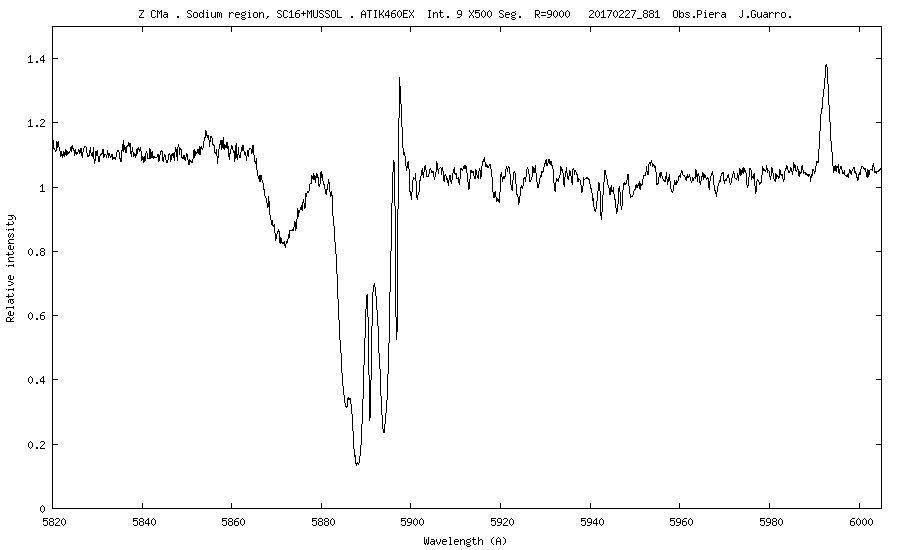

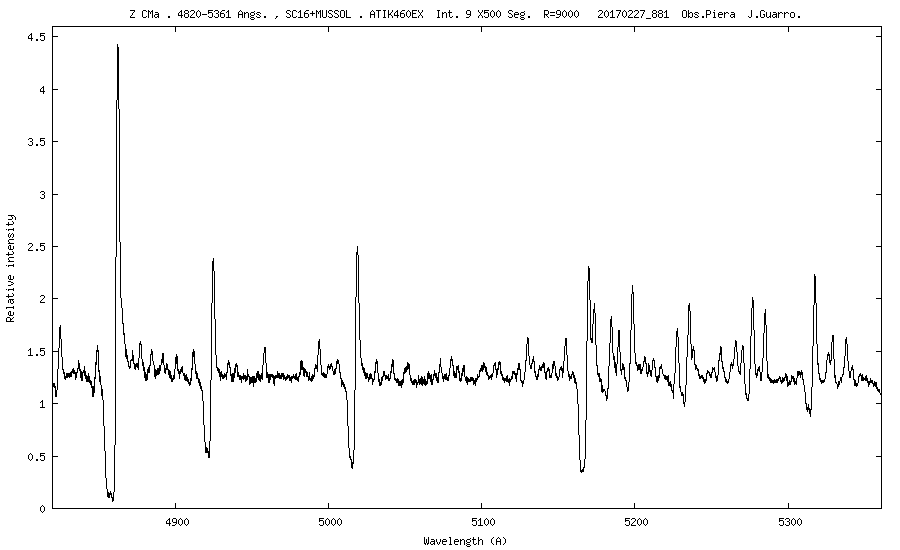

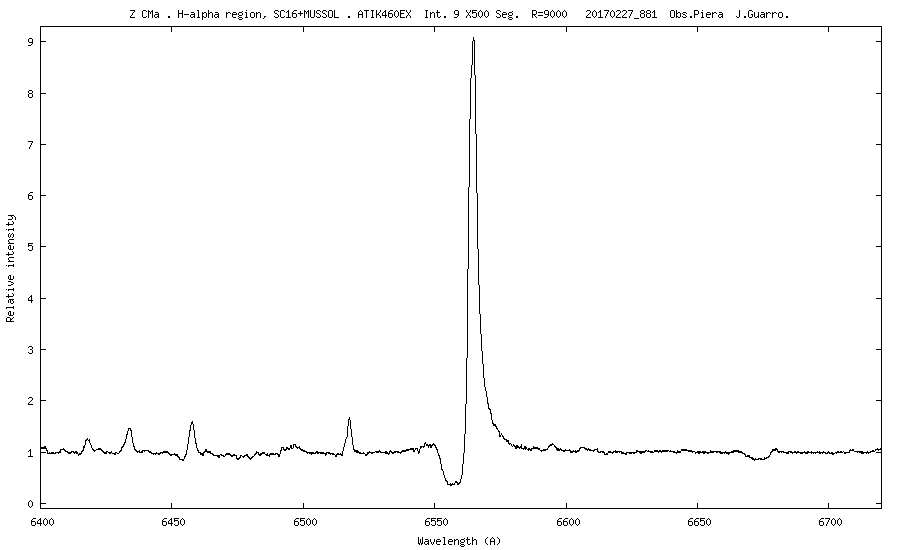

- Posts: 725
Re: Z CMa in outburst
Bonjour à tous:
Ils sont graphiques de Z CMa lors lors la dernière nuit.
Cordialement, Joan.
Cordialement, Joan.
- _zcma_20170227_881_J. Guarro.png (11.39 KiB) Viewed 12154 times
- _zcma_20170227_881_4280-4650.png (9.5 KiB) Viewed 12154 times
- _zcma_20170227_881_4820-5361.png (8.17 KiB) Viewed 12154 times
- _zcma_20170227_881_sodium.png (7.79 KiB) Viewed 12154 times
- _zcma_20170227_881_h-alpha.png (5.95 KiB) Viewed 12154 times

- Posts: 725
Thank you, Etienne.
But, unfortunately, the graphic is not made with the Eshel, is made with the Mussoll. That is a long time already Echelle what I built. Look at, " ISIS AND A NEW ECHELLE", in this Forum.
Now I'm building another Echelle, the LINX can see the mechanical part in, "Nouveau Echelle Linx", in this Forum too.
Regards, Joan.
Regards, Joan.
