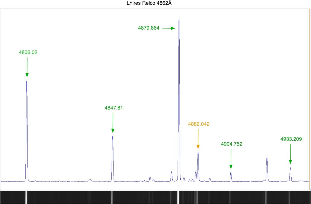

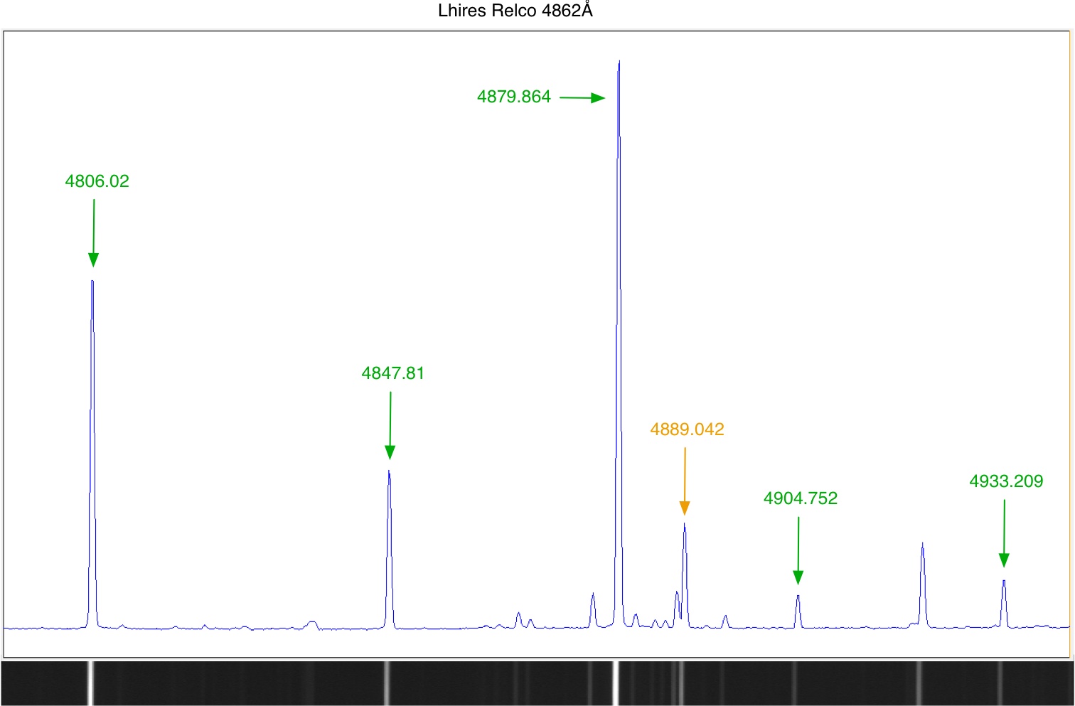

HI James,
Attached is what I use for H-beta with my Lhires + 2400 + relco (note, there are variations in these bulbs). I hope it helps.
Also, Manfred Schwartz has a wonderful resource on his web site which I'm sure he won't mind me sharing:
http://www.astrophoto.at/calibration-arne.html
Paul

Hello James,
Here is my 2x2 bin config for the ATIK 428 for H-beta, I think you can just copy/paste (and later extend with more lines for your ATIK 460 for better accuracy to your chip's edges):
2
0.15352182952182952182952182952183
4806.020
4847.810
4879.864
4889.042
4904.752
You can identify 4847 via looking at ref.star's H-beta place by pixel (read its position first displayed in ISIS), and move to the left next prominent line after switching to the calibration image. I am taking 17 seconds calibration image here, as some of the included lines are weaker.
EDIT: my cal. image (Ar/Ne) almost matching with Pauls except having a few extra blended lines to the right. My bulb is from an extra ordered batch from Shelyak, and I do remember there are slight differences to the older one, but not much.
Posts: 455
Re: Difficulty with LhiresIII H-Beta calibration-2400 l/mm G
To: Peter,
That did it! Using your provided line numbers and my previously calculate dispersion I got this (Processed Isis V5.9.0):
Here is the .lst file numbers I used:
2
0.112438486
4806.020
4847.810
4879.864
4889.042
4904.752
Will process the R Aqr, CH Cyg, gam CAS, CH Cyg, etc Ha & Hb spectra I've taken over the last week....thanks again!
