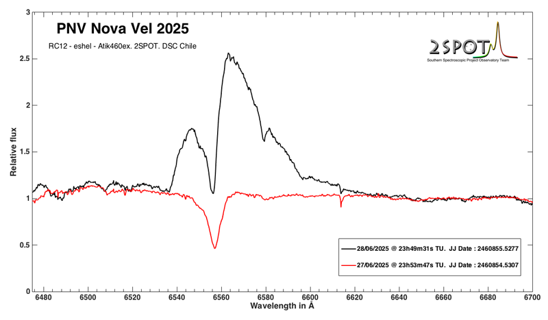

A fast change in the profil of this Nova in less than 24h

The Halpha profile displayed an abrupt, dramatic change on MJD 60855, showing an emission component at 1.5 times the continuum extending from about -1200 km/s to +2700 km/s but with absorption (now only to the continuum level) at -280 km/s. The absorption profile also remained unchanged despite the intense emission.

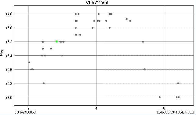

AAVSO visual lightcurve:
