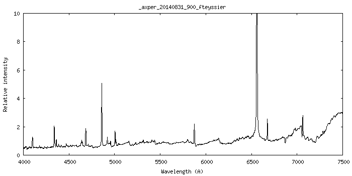

- Posts: 1557
Re: Symbiotic AX Per in outburst
AX Per
Note also the low ratio [OIII] 5007/ [OIII] 4363
Temperature of the hot star drecrease during the outburst (expansion of the envelop)
[Fe VII] lines have disappeared during the outburstNote also the low ratio [OIII] 5007/ [OIII] 4363

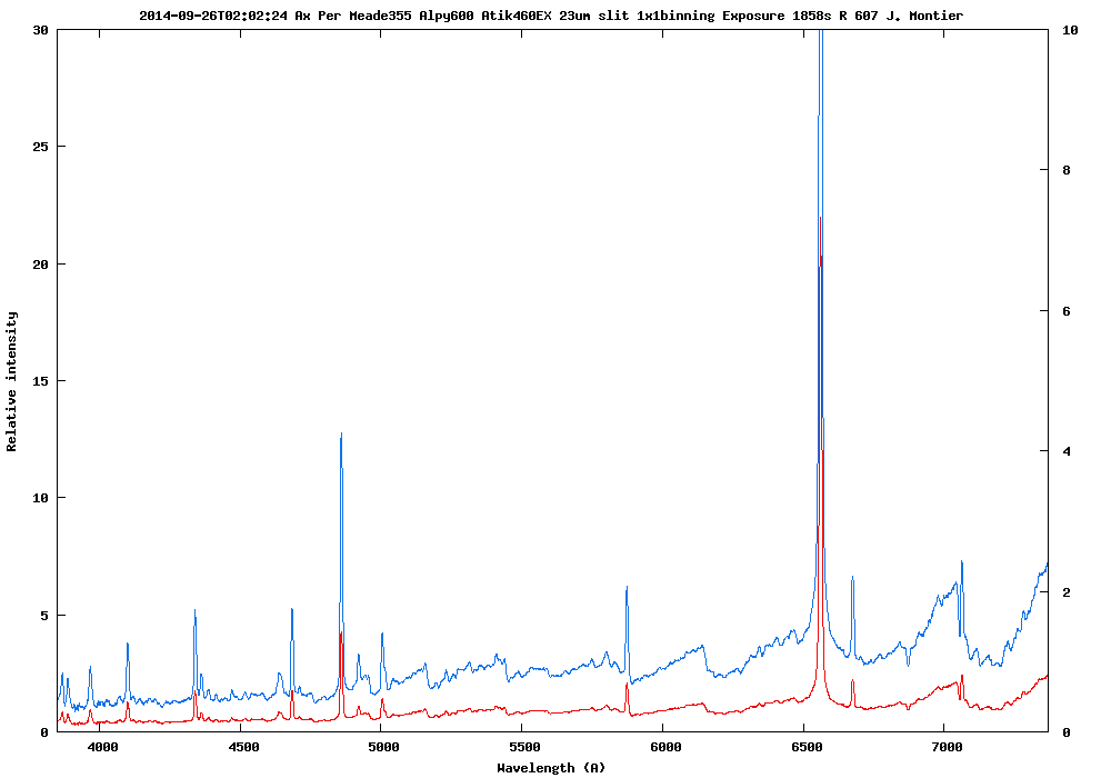

- Posts: 242
Ax Per on 26/09
Regards,
Ax Per on 26/09
Regards,
Jacques Montier
IAU code J23
Jacques Montier
IAU code J23

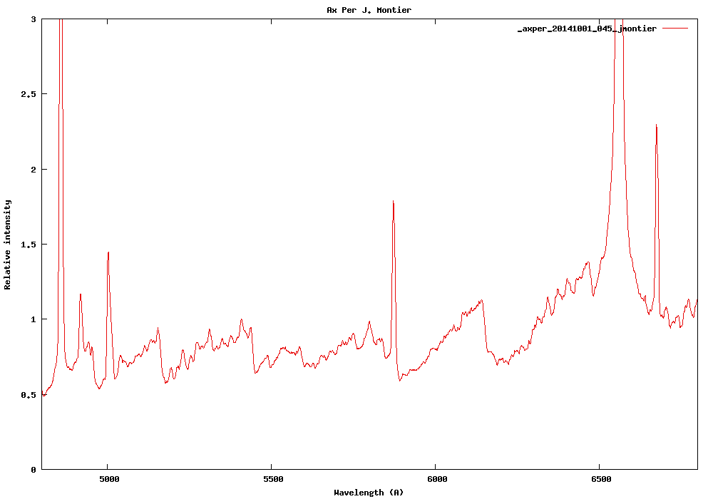

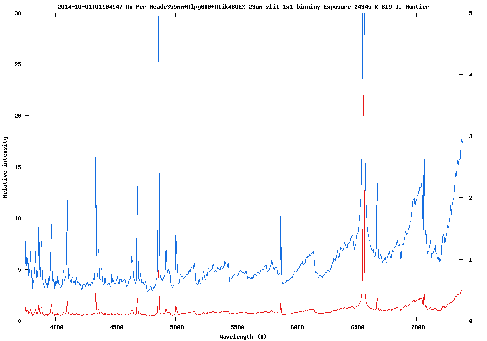

- Posts: 242
Ax Per on 01/10
Regards,
Ax Per on 01/10
Regards,
Jacques Montier
IAU code J23
Jacques Montier
IAU code J23
