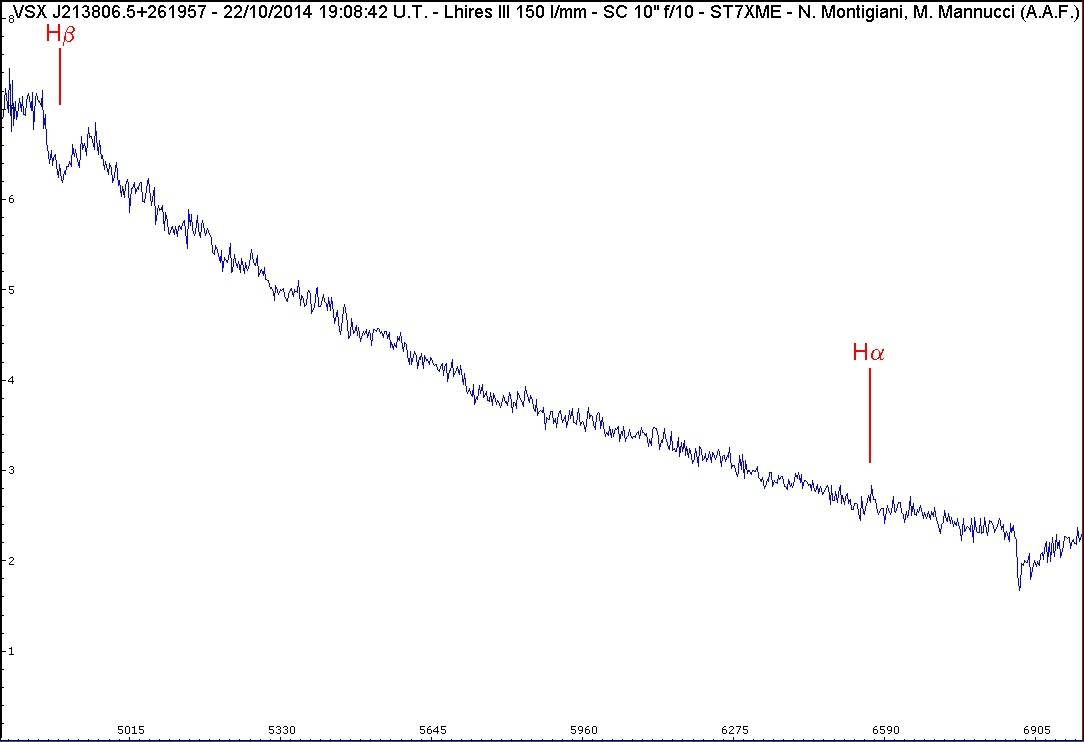

As per François Teyssier alert in [spectro-l], here below our spectrum taken on 22/10/2014 around 19:00 UT of the star VSX J213806.5+261957.
Unfortunately the sky was strongly spoiled by clouds and veils and this has compromised the SNR of our images.
The target has been calibrated using a Miles star F class. We would have preferred to use a reference star with more blue spectrum but unfortunately the weather condition obliged us to be as fast as possible in collecting the reference spectrum. So we have choosen the closest and brightest available star from Miles catalogue.
Here the weather is very variable, we hope someone else will be able to collect further spectra.
Regards
Massimiliano Mannucci
Nico Montigiani

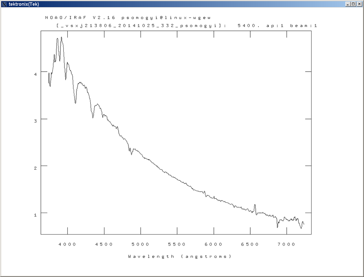

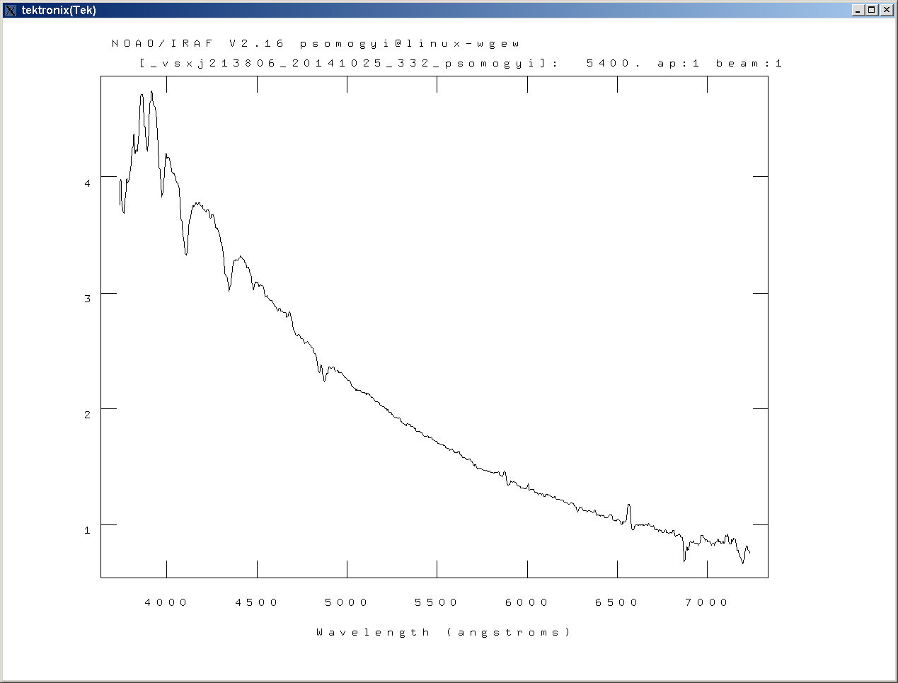

Fresh capture (250/1000 Newt, Alpy 600, Orion G3, 5400 sec):
Re: Outburst of VSX J213806.5+261957 (ugwz in Pegasus)
Reference star was: 35-Vul

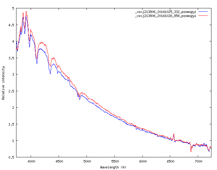

Had one more occasion yesterday, the whole weekend's result:
Note: the 20141025_332 name has a 12-hours skew error - came from OrionStudio's time field limited by 12-hours without any AM/PM info, disagreeing with my script that fixes date field to make ISIS runnable and was guessing AM/PM wrongly...so that was taken around 10.25 7:00 PM too - sorry for this error!

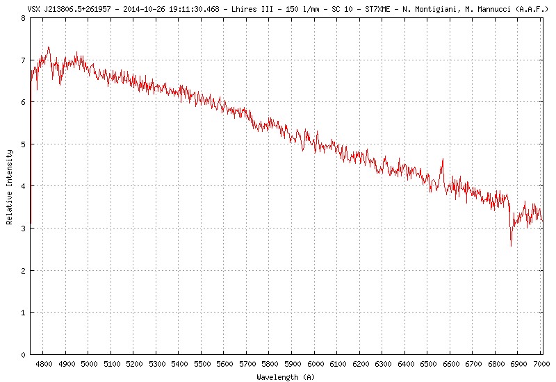

Tonight
Massimiliano M
Posts: 10
Joined: Sat Aug 23, 2014 6:31 am
Location: Pontedera (Pisa) - Italy
Post by Massimiliano M »
Yesterday observation.
Max
