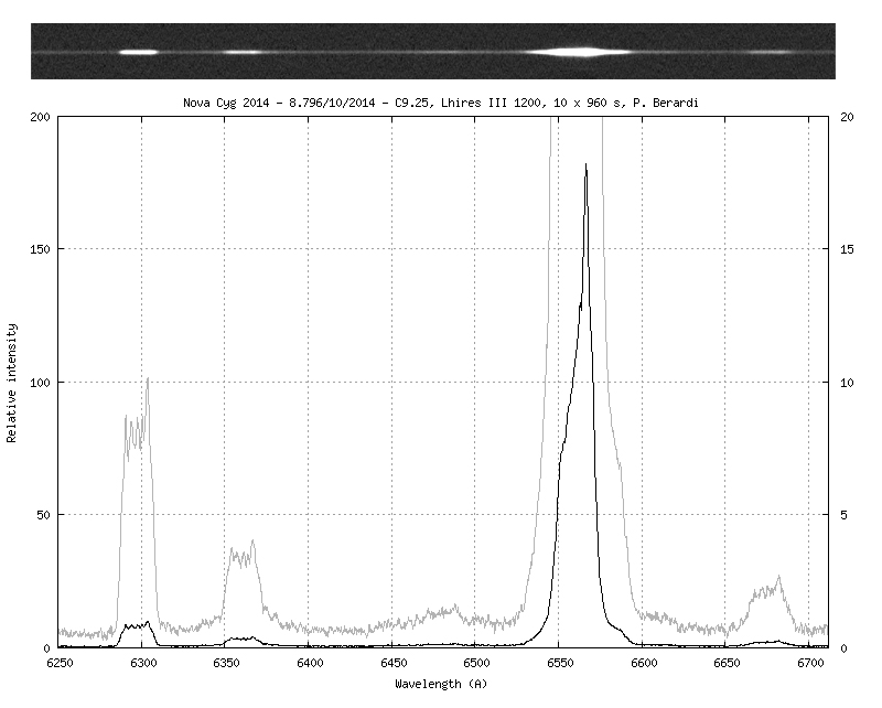

My last observation for 8.796 october. H-alpha region, R~6000:
