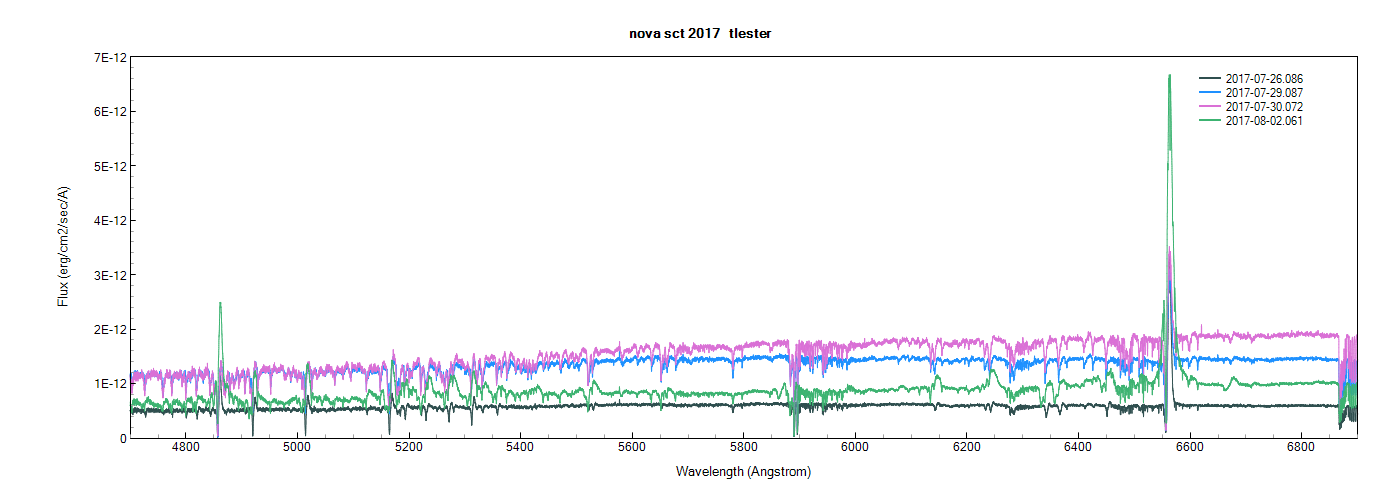

Post by Tim Lester »
Aug 2 - Balmer lines have increased significantly!
Here are my spectra so far converted to aprox. flux using AAVSO data.
