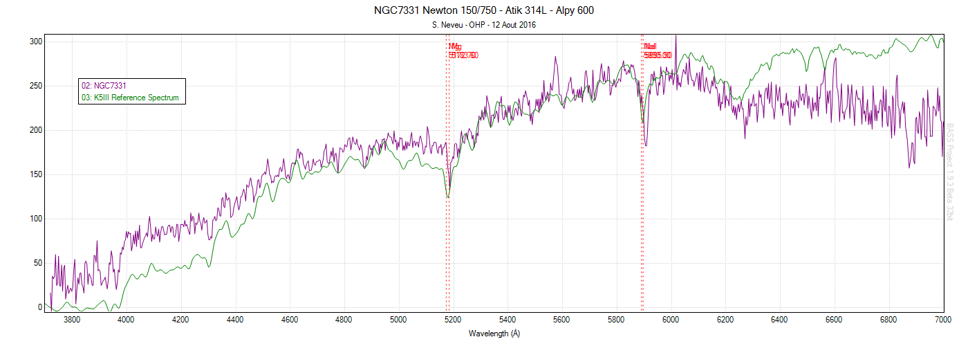

NGC7331 :
Na = 5907A ; Na repos = 5893A ; z = 0.002375
NII = 6599A ; NII au repos = 6583A ; z = 0.00243
moyenne z = 0.0024025
Vitesse = 0.0024025 x 299 792.458
V = 720.25 km/s vitesse héliocentrique = 22.805 km/s
Vitesse = 697.4 km/s
NGC588 : HII (ionized) region
[OIII] = 5005A ; [OIII] repos = 5007A ; z = -0.0003994
Ha = 6561A ; Ha au repos = 6562.8A ; z = -0.0002742
moyenne z = -0.0003368
Vitesse = -0.0003368 x 299 792.458
V = -100.97 km/s vitesse héliocentrique = 23.882 km/s
Vitesse = -124.85 km/s
