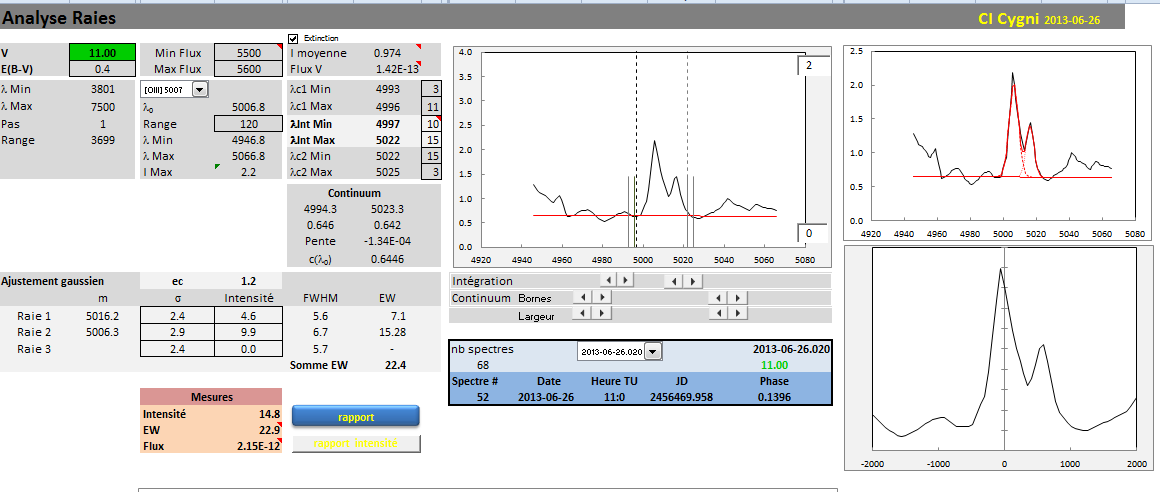

Here's an example with [OIII] and He I lines of CI Cyg
A can send you the sheet if you want

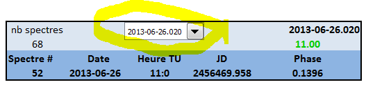

You add the V mag line 3
In the sheet "index" , you choose your spectrum

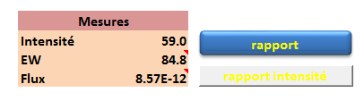

The result : EW, Absolute flux appears in
By clicking on "Rapport", the sheets "Rapport G1" = EW and "RapportG2" = Absolute flux are updated

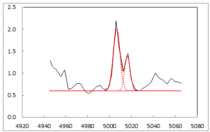

For gaussian fitting

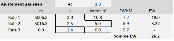

Choose [OIII] 5007 line, adjust continuum, integration zone (the two lines 5007 and 5016 in the integration zone)

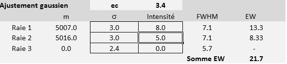

In cells B21:B23, D21:D23 and E21:E23, give approximative values
For instance

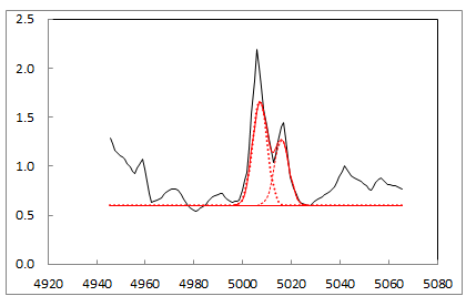

The result appears in the left graph :
Then, use the Solver (In the "Données" windows of EXCEL2010, don't know the name of the window in Englisg Version
The result :
and the values :
With two lines, they are to be copied manually in Sheets Rapport (I've to build a macro ...)

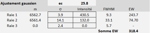

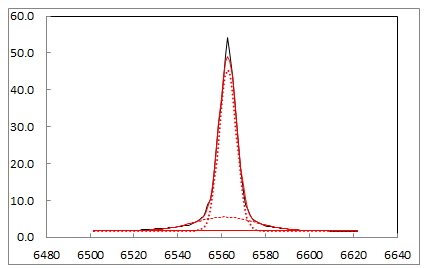

You can also fit other lines
For instance, H alpha lines in symbiotic are the sum of two gaussian (a broad one for the piedestal and anarrower for he main component)
and
